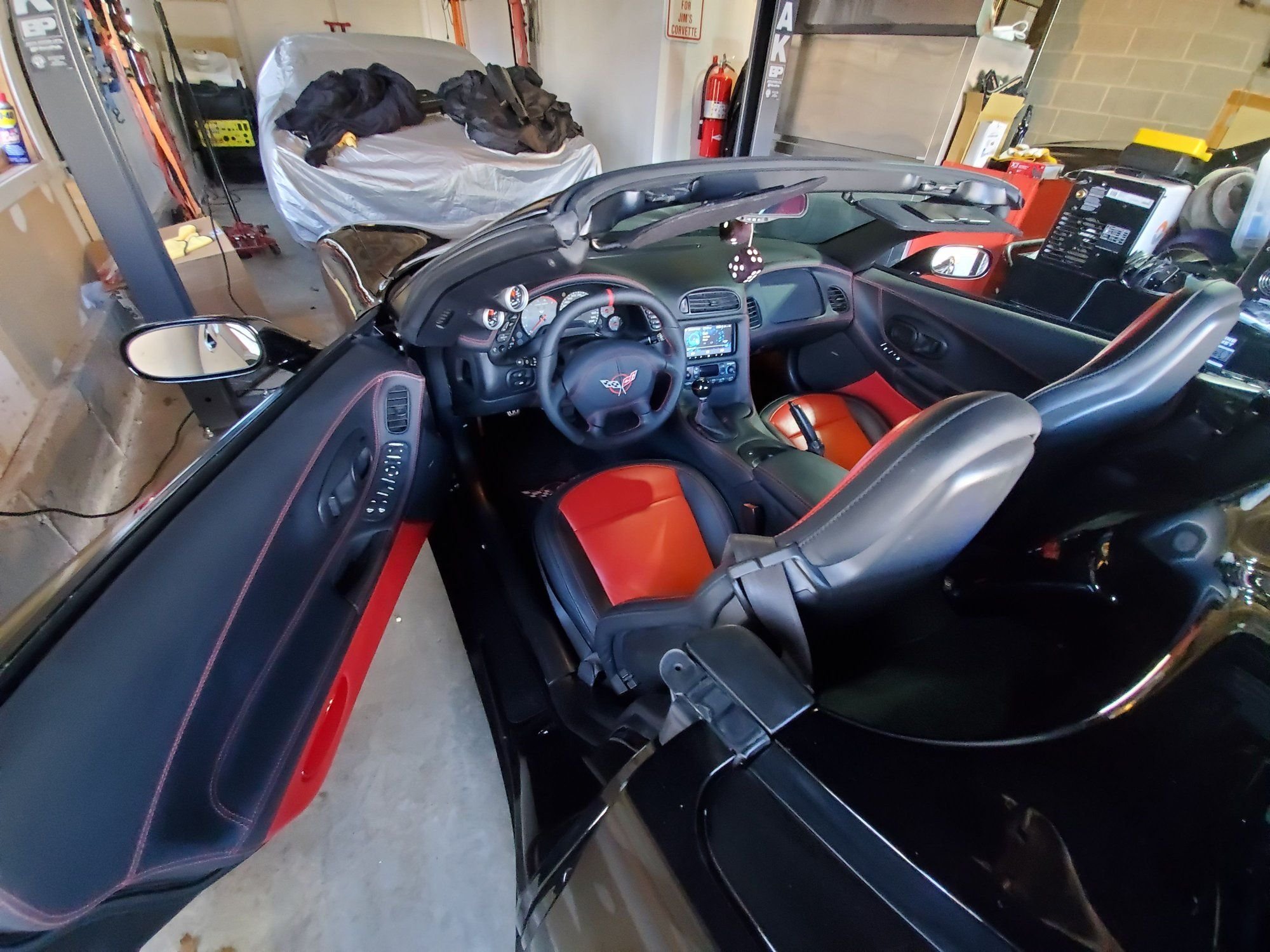

Although this is an old thread, seeing as OP is still asking questions...
IMHO, don't waste your time buying leather-wrapped parts from vendors. I did that for my dash, and although it was high quality, you'll end up spending about the same, and getting exactly what you want by going to a high-quality, local upholsterer. I went to a local guy that did private jet interiors, and other than the dash, he did everything in my car (and removed/installed the dash for me). If I was going to do it again, I'd had just had him do the entire interior, a lot less work on my end and looks better, and you can select whatever leather quality/color/style and stitching that you want. For reference, here's my interior, w/ c7 seats:

What was the rough cost for all that?

Was going to ask, who did the work? That looks like class! Love it!

I had it done by a local upholsterer when I lived in NY, they did interiors for private business jets. Generally, the leather used in private jets is of better quality than automotive, and it shows.
Some of the pieces I got from Apsis

It’s the best leather C5 interior that I’ve seen. Total class! It’s interesting that you’re finding a difference in leather quality in aircraft vs automotive. Was given a bottle of leather aircraft seat conditioner by a private pilot, and my C5 seats are like new, maybe better. Sounds like there’s something to the aircraft grade leather, including the products they use to keep it perfect.
