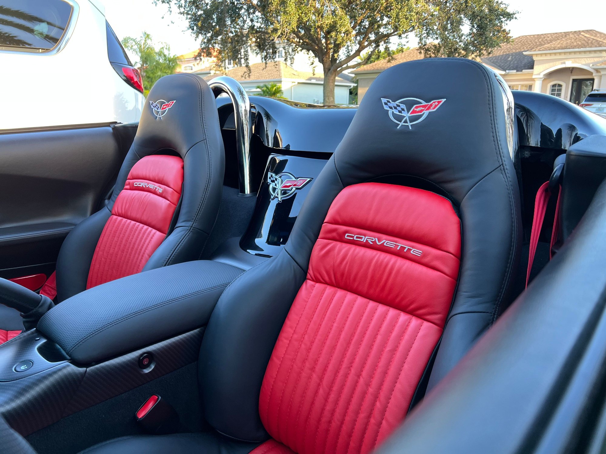

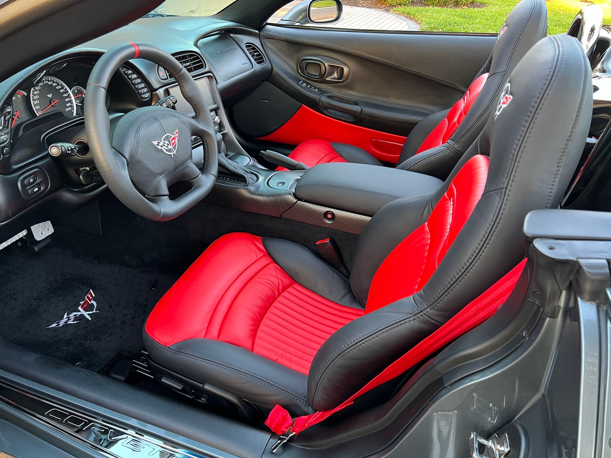

I went with the 100% leather sports seat option offered by Top Flight Automotive, aka Corvette America. My seats are the Black with Torch Red inserts, however they offer other colors including Firethorn Red. They offer both 100% leather and the less expensive, leather-like vinyl both in standard and sport seat styles. They also have replacement seat foam and have the GM licensing rights to use the Corvette lettering and C5 logo if that's important to you.
Below is a link to the Firethorn 100% leather sport seats:
https://www.topflightautomotive.com/...0Red%20Inserts
Pics of my seats:

My lesson learned....
I rebuilt the seats with new foam and some automotive rubber burlap to prevent the seat springs/wires and sharp edges from cutting into the new foam as that's the primary reason the stock/OEM seats fail and get soft over time. I tried rebuilding the passenger seat first and although I was able to get the new foam and covers on over the automotive rubber burlap, I didn't like the finish as the leather appeared loose in some areas and tighter in others with some wrinkles at the corners.
So I decided to stop and work with a local automotive upholstery shop. I had them redo my passenger seat and rebuild the driver seat with the new skins, foam, and rubber burlap I provided. I'm glad I did as it's really in the tools used. The shop had a table that looked like a medieval torture device which used wires and hooks to stretch the new leather over the seat foam and seat frame. While using the hooks to stretch the leather, they also used a steam machine to work out the wrinkles and to better fit the leather around the corners of the seat frame and then finished off work with better clamps than the ones provided.
Definitely worth it in my opinion to get it done professionally. There are a bunch of do it yourself photos online and you can definitely tell the difference in the finished product when the work is performed by a pro shop that has the right tools.

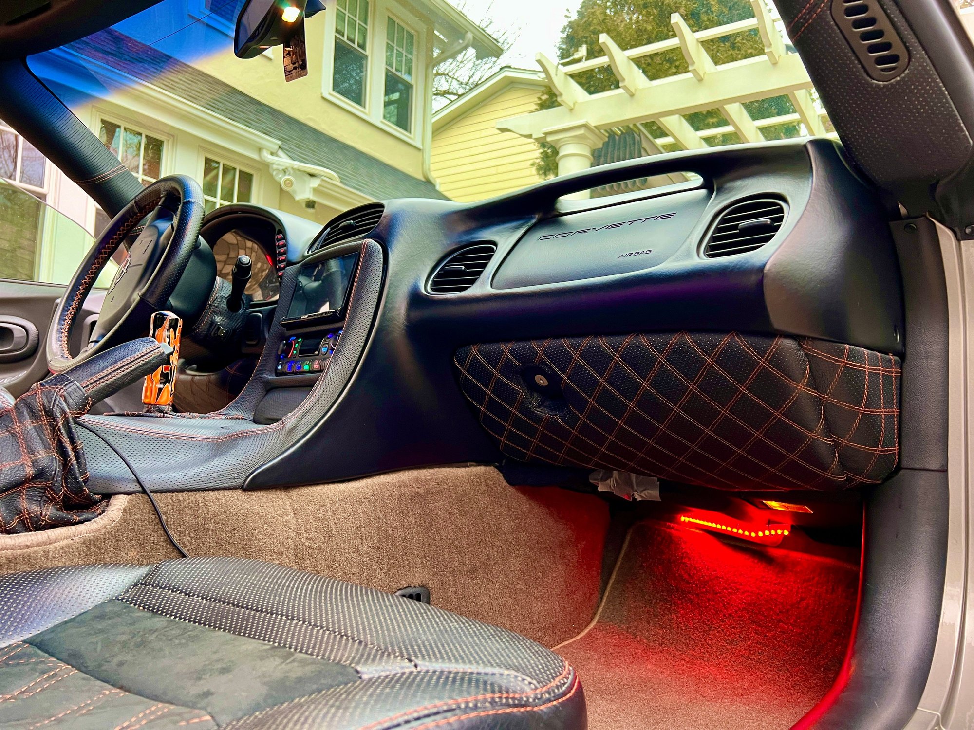

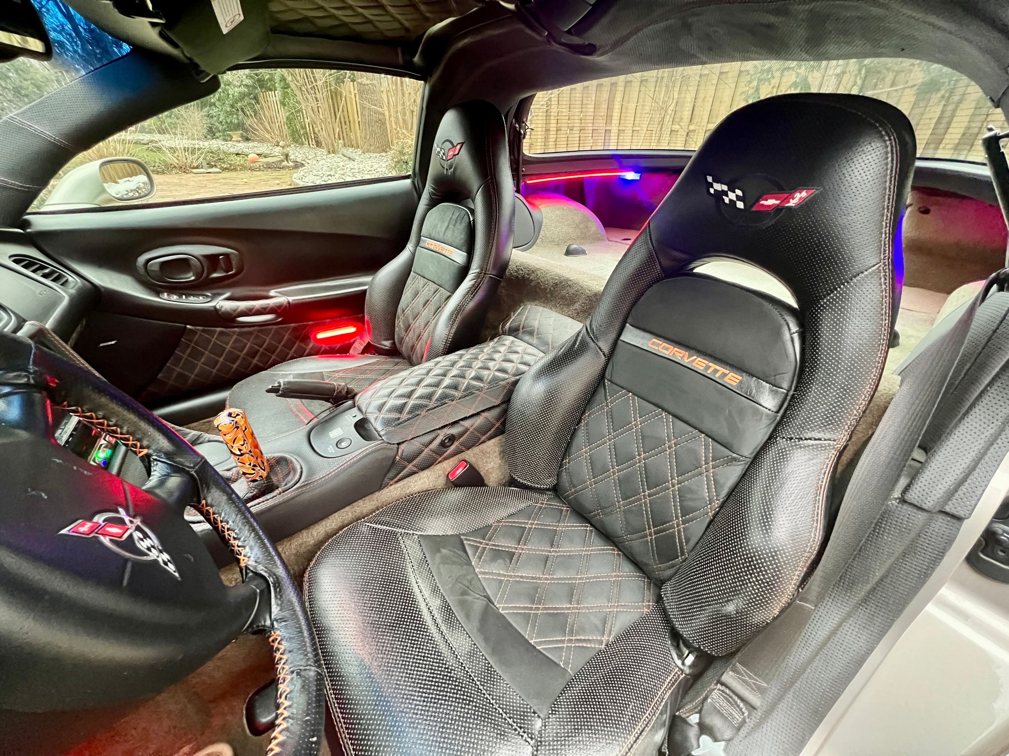

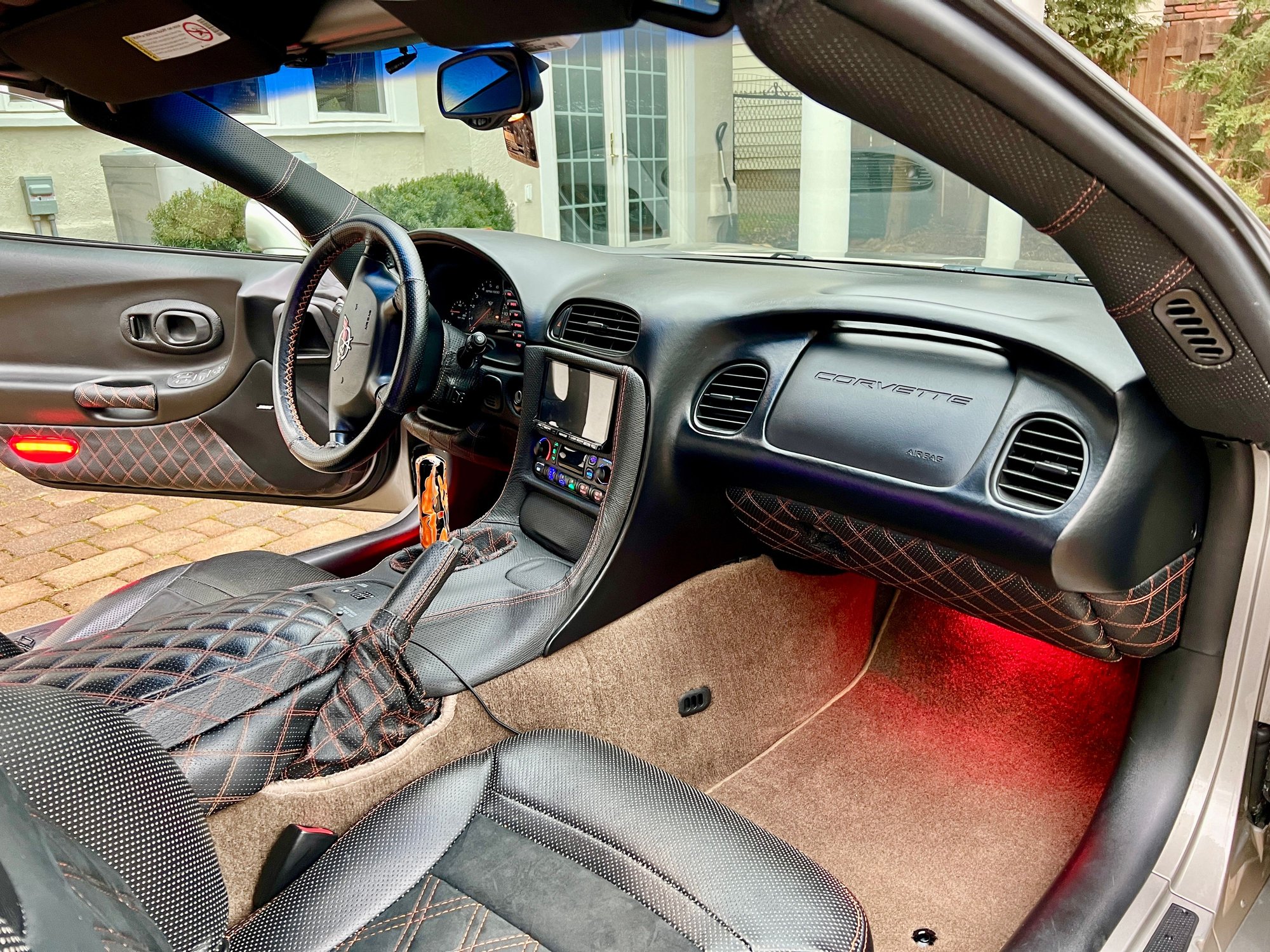

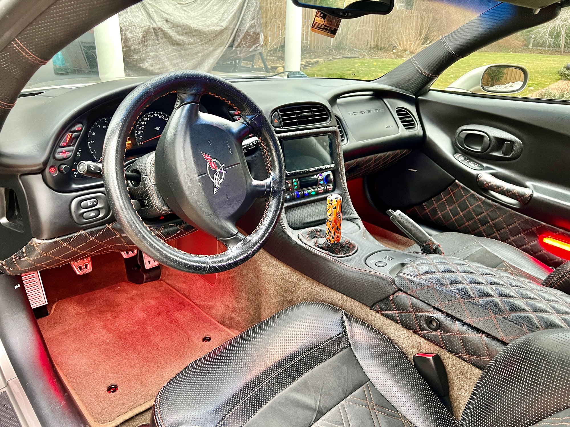

Not trying to be a troublemaker but I did these seats myself, from Interior Innovations, sometimes associated with Ridies. They are full custom with new foam. Yes, I wrestled with them but in this case I made the entire interior my own, including carpets and trim areas. This was about 8 years ago, so I’m unsure even if either of them are in business but they provide a good product and did have stock GM colors at the time. I’m “back’ because I just bought my 3rd C5, but I have other plans for the interior of the next one. I was quoted back then about $2500 to do the seats from a great shop. I’m an obsessive DIY’er and did it for 1/3 the price and learned a lot in the meantime. I’m 78 now and my arthritic hands will get back at me with a vengeance if I try working with uncooperative leather again!

No trouble, looks like you did quite a bit of work that came out great. The entire interior refit is a big lift. Your skill level in upholstery is likely beyond mine. For sure your patience level is I imagine - Thanks for sharing.
