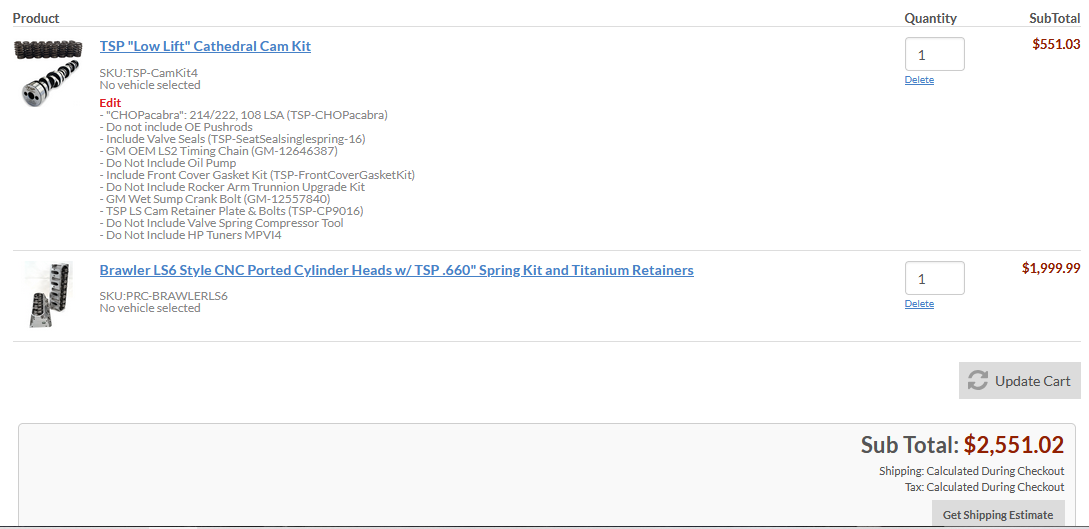

I WAG'ed a kit based on the chop cam you said you wanted. Its low lift, like mine, so easy on valve train. Get an oil pump as Summit brand or Melling. You can add a Melling red spring on the std Summit/Melling pump if you want a bit more pressure on the pump. Everyone sells pushrods in the sizes you will need. TSP LS6 Brawler heads are a no brainer for what they cost and what you get. I'm sure they'd substitute a single Beehive spring if you want. Double springs would be for higher lift cams. Call TSP to see what they say. Summit now sells their brand LS6 style LS heads now as well. I think they are re-branded Trick Flow's. Neither were available when I did my upgrades.
Cam On sale heads not

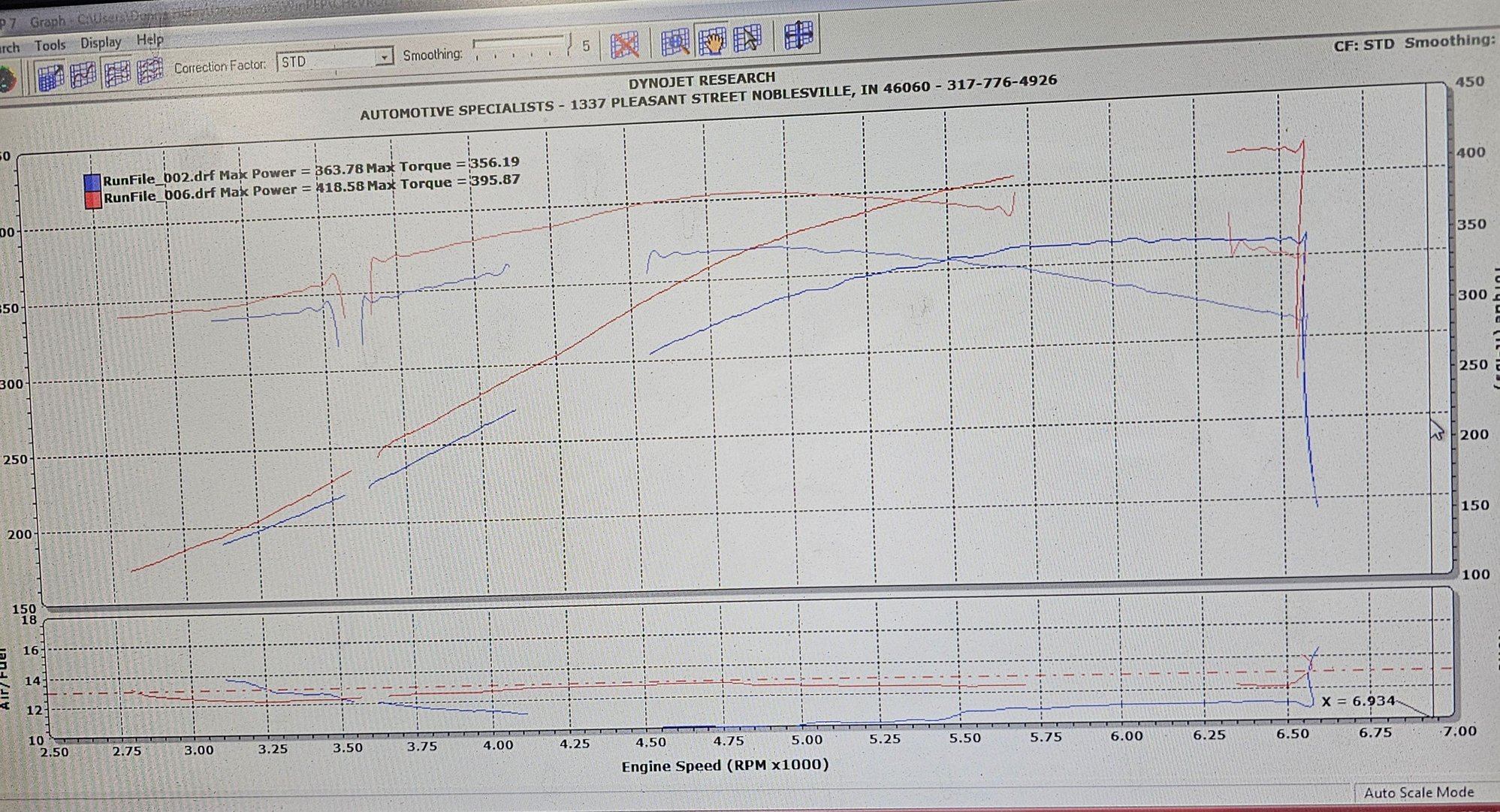

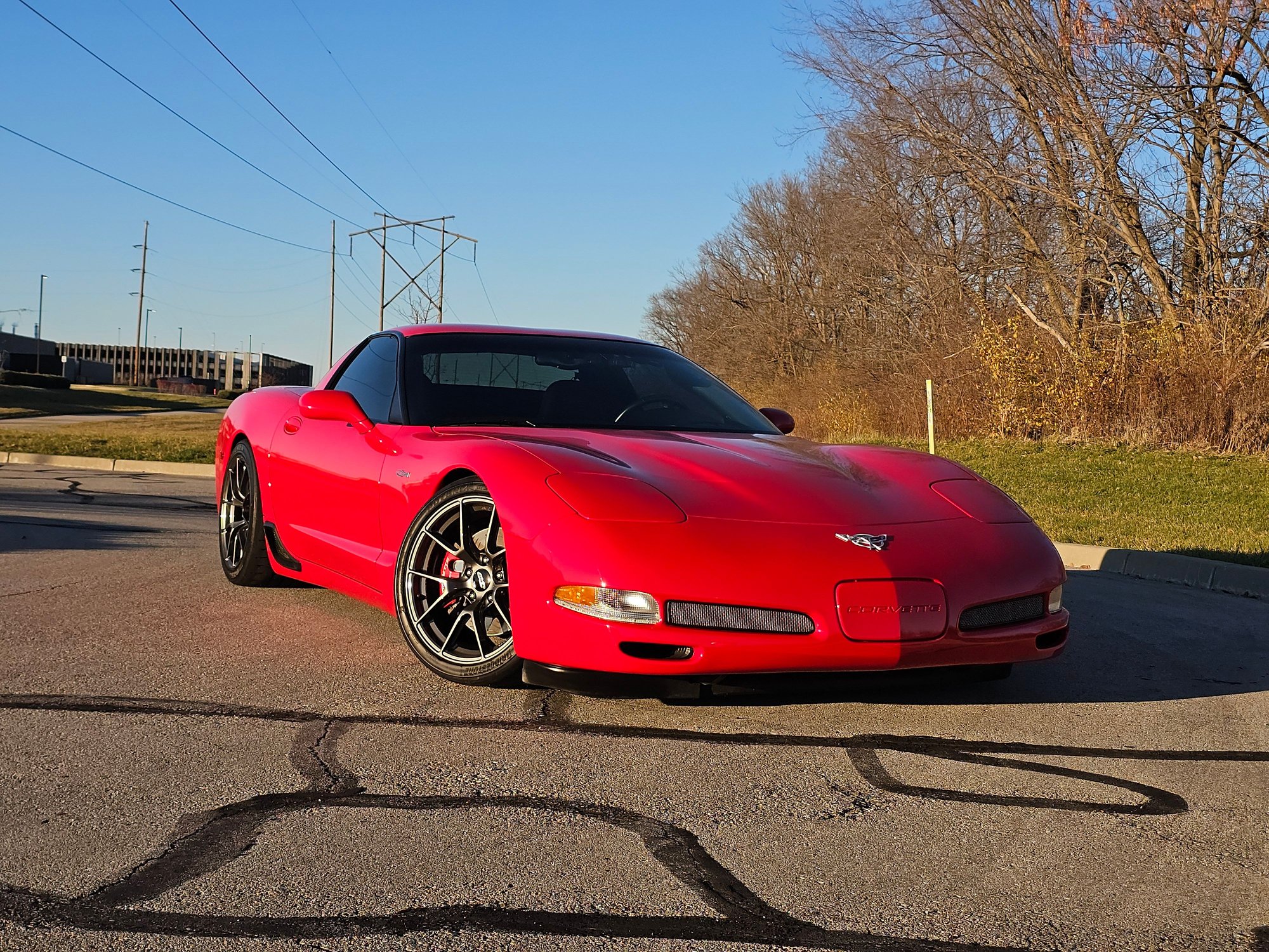

I went through this last fall. I wanted a power and torque increase everywhere, as my car doesn't live between 5000-6500 rpms constantly. I also autocross the car and need it to not be a limp noodle in the 2500-4000 rpm range. I called BTR and they suggested a Stage 1 or 2. I went with a Stage 2. I paired that with Speed Engineering longtubes and X. My car has no other power mods. Stock airbox with a paper filter. I hopped on my local Dynojet before, had it installed and street tuned and then went back. It gained 50 rwhp and 42 rwtq. The increase is very noticeable and the car is a lot of fun. The choppy idle we all love is present as well. This is the most streetable cam I've ever experienced. It's downright tame to drive from a dead stop. Tell you this, my 18 y/o daughter learned to drive a stick w/this setup if that tells you anything. I would do this again in a heartbeat. On 200 tw tires and concrete, it will hook really well in 1st and will take all of 2nd on every surface I've tried on. It's in a sweet spot at the moment.
What's the deets on this wheels? Look good!
Old Jan 28, 2026 | 07:10 AM
