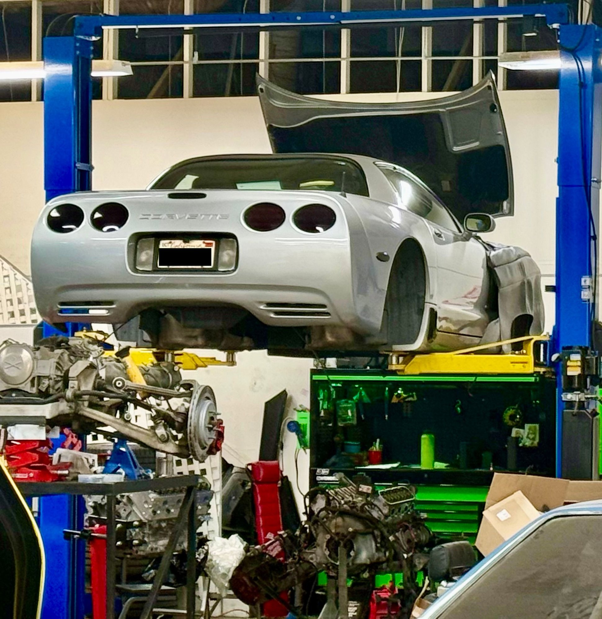

The shortblock is here!

Old Feb 21, 2026 | 12:43 AM
Lowend's Avatar
Lowend
Joined: Jan 2001
Posts: 642
Likes: 342
From: San Jose CA
And... she's back.
So I've I've met all of my goals. The rev-speed is very fast, it looks stock, and pretty much sounds stock at idle.
I need to behave myself for a few hundred miles while the engine and clutch break-in.

Old May 8, 2026 | 02:37 PM
  #33
Lowend's Avatar
Lowend
Joined: Jan 2001
Posts: 642
Likes: 342
From: San Jose CA
UPDATE -
Got chassis dyno'd yesterday and the results are no. No real surprises here
The SAE numbers are about 8WHP lower. In general this dyno tends to read a little more conservative but the curves are accurate.
The engine looks and sounds stock and passes all CA Smog.
C5 transaxles are ~ 13% drivetrain loss, so this is right about 450 FWHP, as expected
Peak HP is about 900 RPM lower than I expected, but I'm happy with the results.
This torque curve is very "me" ie there's power everywhere.
For those following along at home, this is on Factory 2002 Z06 fuel injectors, they peaked out at 89% during the tuning. A little more than I'd like in a perfect world, but still safe.
LS6 chassis dyno
Would more power be nice... always. But with the goal of a smog legal car that's bullet proof, I'm saying mission accomplished. In a perfect world I would have run a little more cam. I really couldn't have gone with any more duration and still had the factory programming get me through smog (damn you CARB)
The car drives great, smoother than a new one and just goes.
I a couple years it may get an A&A supercharger kit, but for now great canyon carver.
