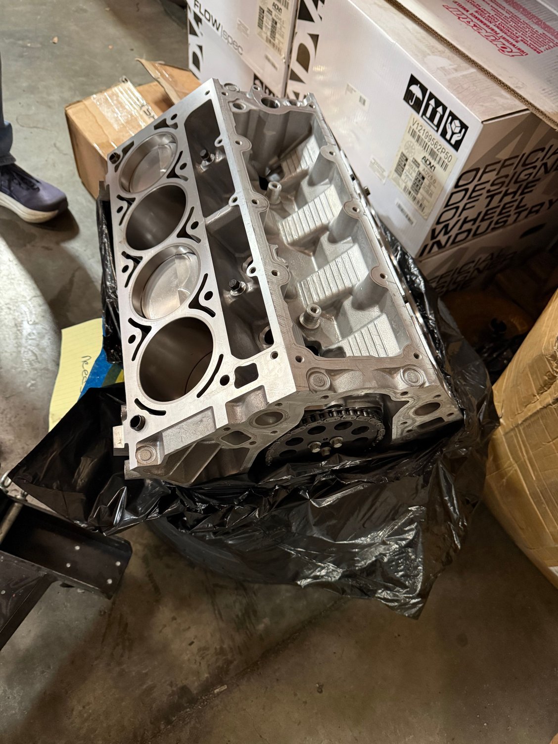

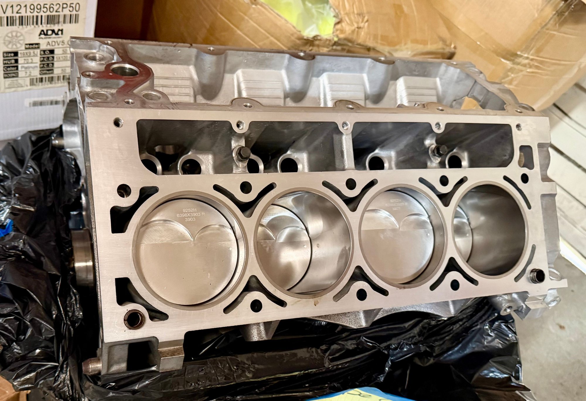

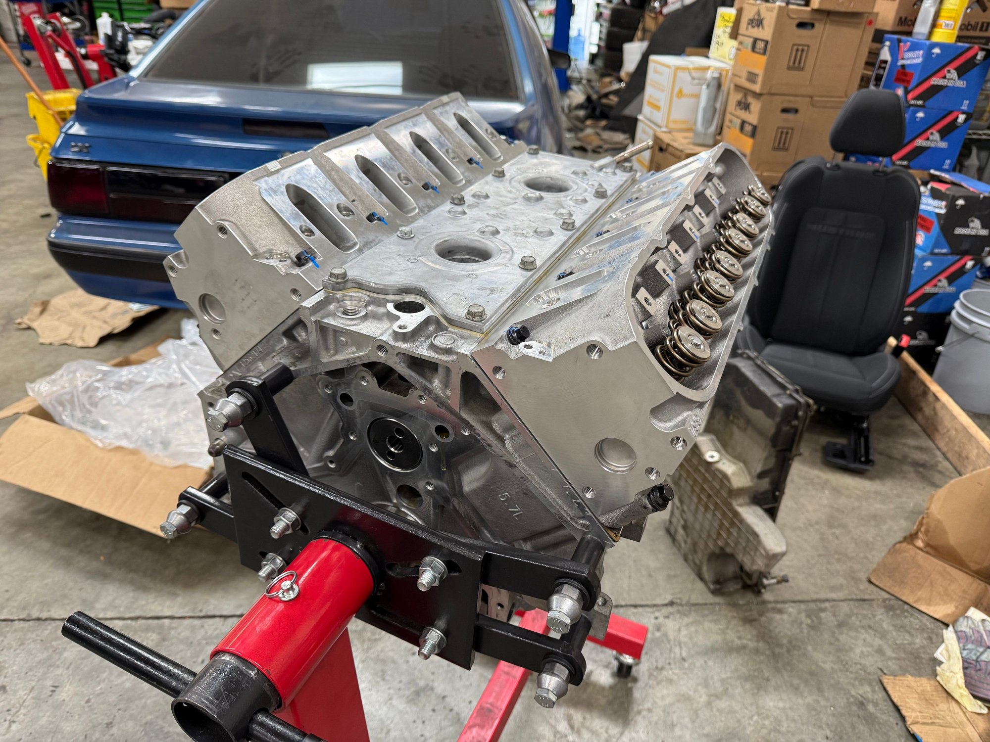

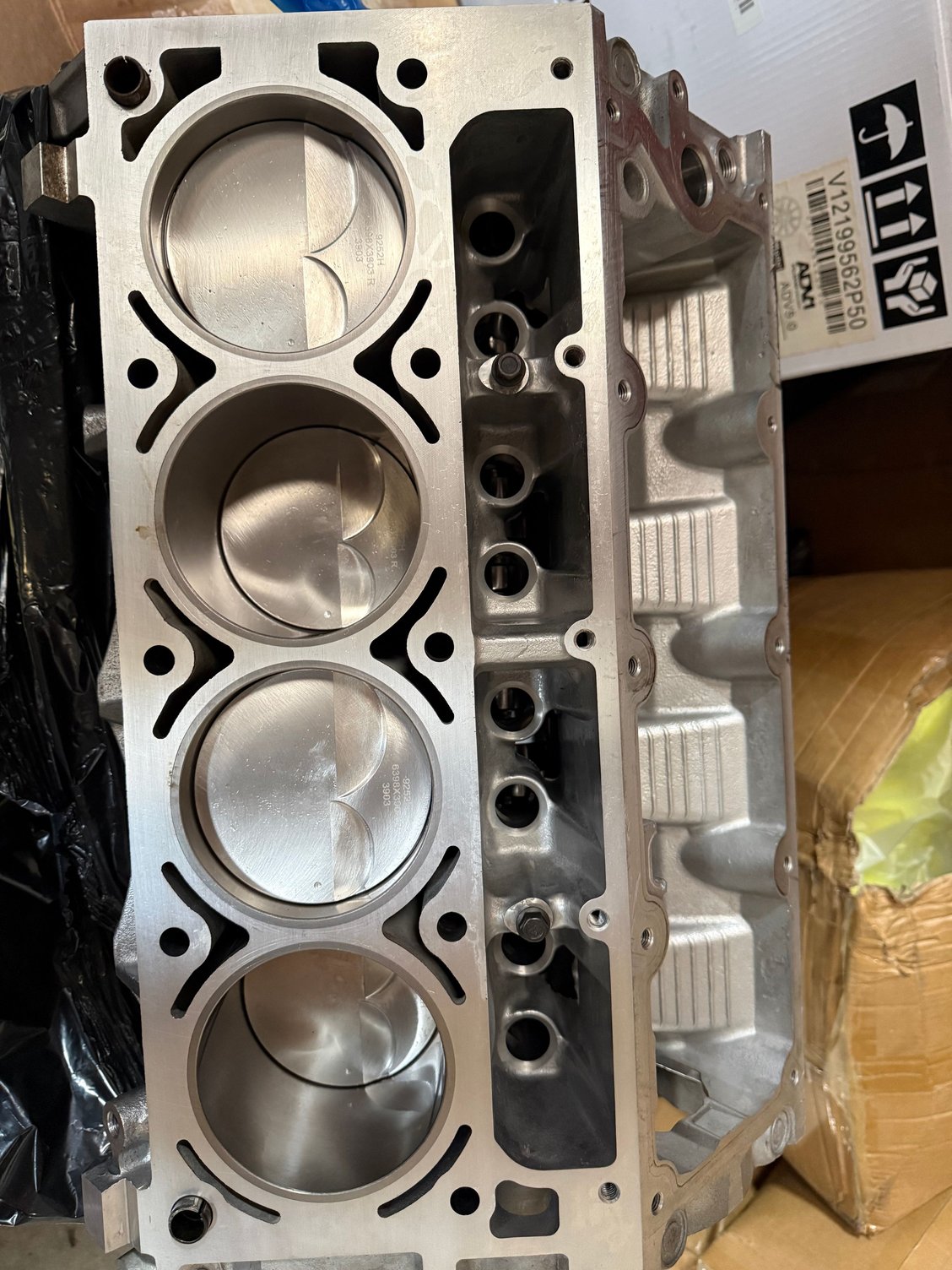

My shortblock is finally back from the machine shop and I'm getting excited!
It's a rebuilt Gen III motor
3.903 bore Weisco forged pistons with 5cc valve relief - decked and balanced.
Eagle forged I beam rods with arp 2000 rods bolts 6.125
Arp main rods / head bolts, cam sprocket
Melling performance 295 fuel pump with copo high pressure spring for high rpm road race / street application
The Cam is the Comp FSL (210/218)
Next to be installed is a set of CNC ported 243/799 heads
This is gonna be a nice street motor...

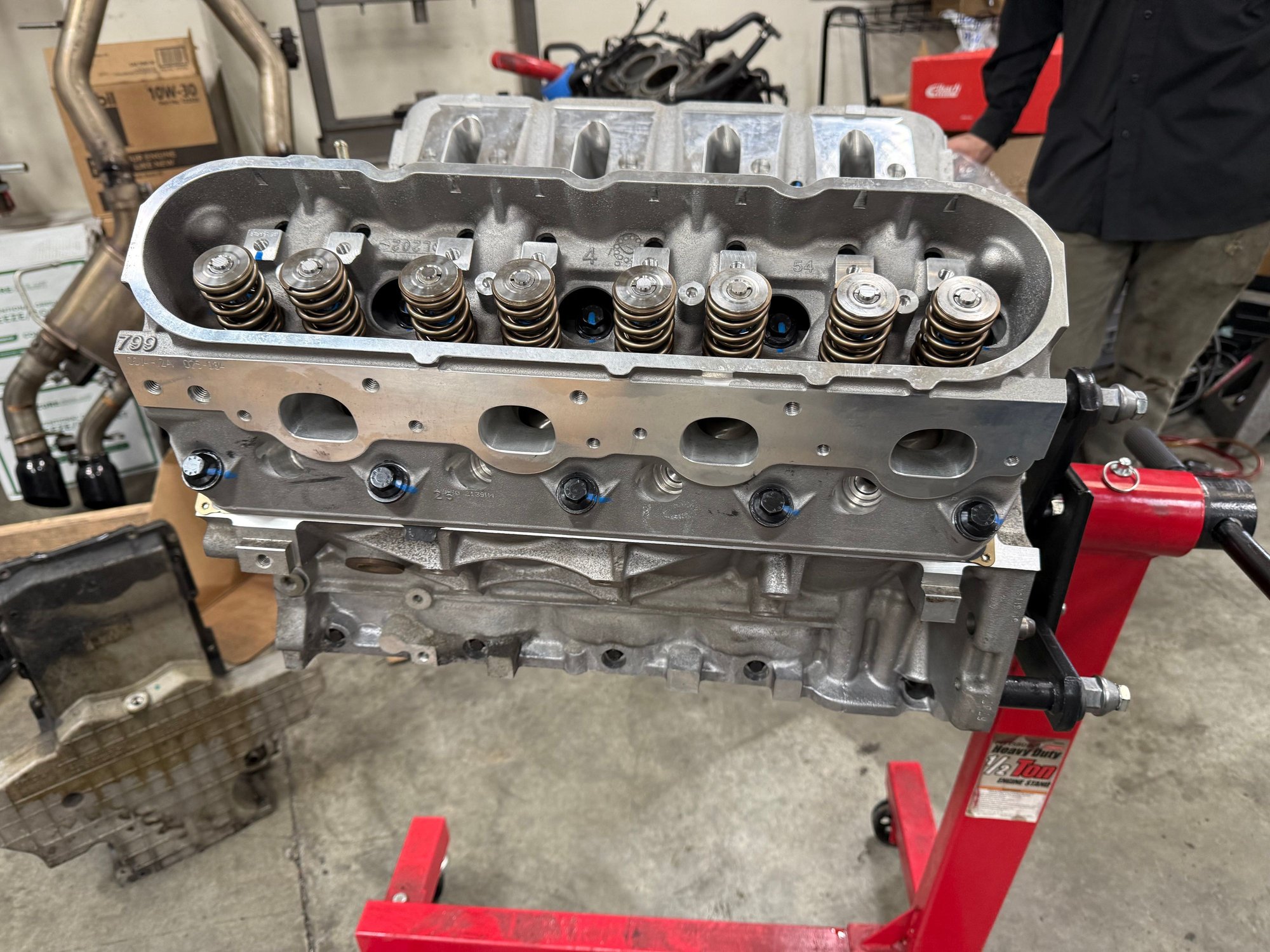

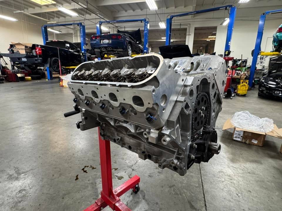

Dropped the car off at the shop for the R&R earlier today. The Long Block is lookin good

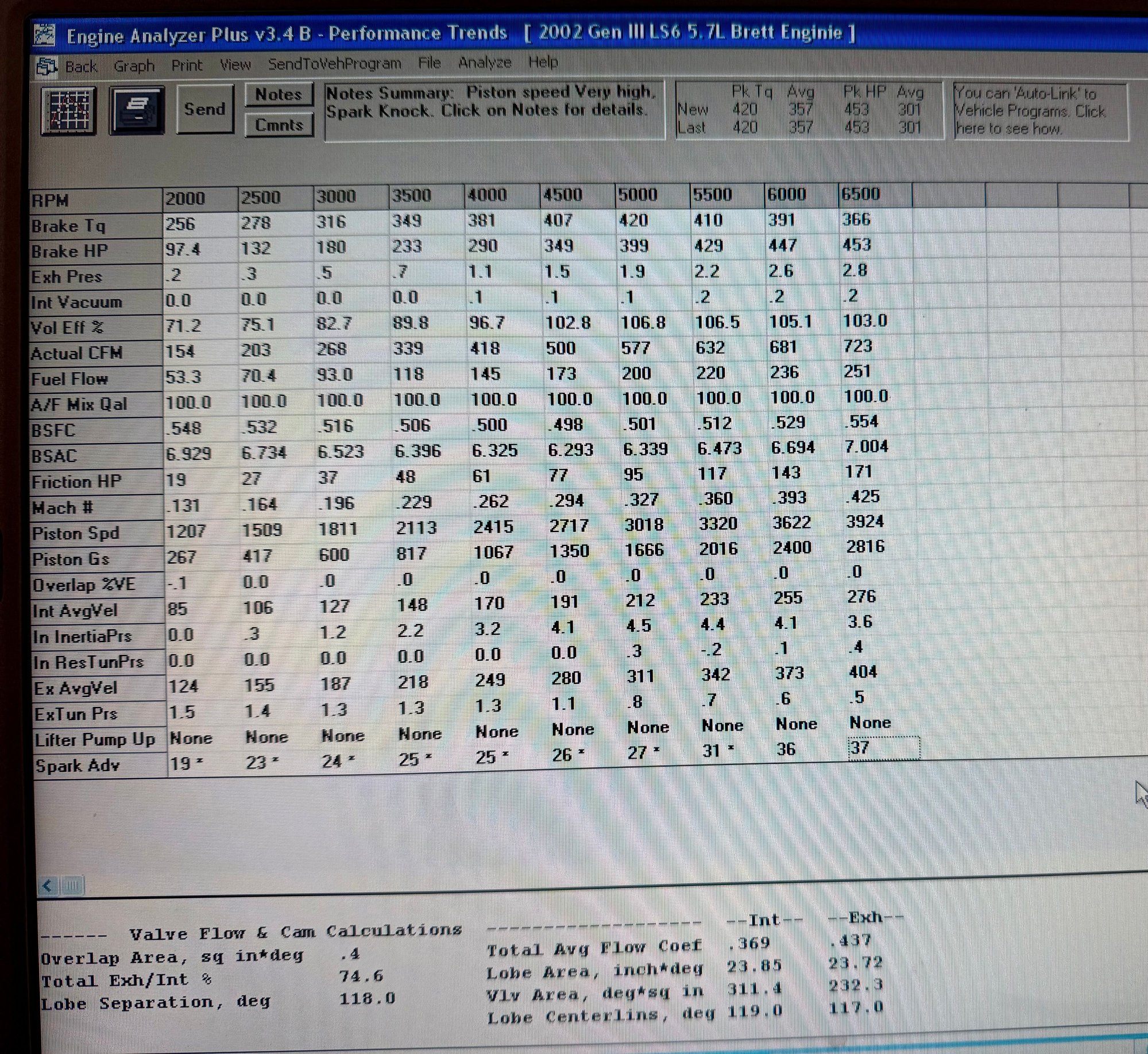

this is the engine modeling I’ve done, it assumes 91 octane fuel and full accessory load
In my experience with good data and analyzer is extremely accurate
This is gonna sound bad, but I don’t mean it to.
How does an almost stock cam fit in with expected high rpm track use? Also, on appearance, that cam doesn’t seem to align with 453 hp, granted head work more ci?
Again, not judging, so just trying to learn more about combinations..
Well, he refers to it as being a street motor.
The FSL in the "Fifty States Legal" cam's title says a bunch about it. Some much bigger cams are smog legal when sniffed as it depends on the timing and a clean, isolated burn which doesn't pass any fresh fuel into the exhaust - as well as a proper tune. From experience with friends you can get a Jam Cam to pass CT emissions done right. If he's in CA (I didn't check location but it is presumed when someone says 'FSL' related to a build) maybe this one gets a pass?
This one's overlap is -22, so it has a very clean burn and ought to get good mpg.
Heads and cam together? CNC'd 243s generally being known for good low and mid lift prop this low lift cam up. He'll gain an easy average 35whp and 40wtq under the curve with peak gains being maybe.... 65whp and 45wtq gain over stock? This one should still be shifted at 6k, but the torque will at least keep building up to that point. Any gains here are almost exclusively derived from the increased flow of the heads which in this case benefit mid-range lift and that is where this stealth cam lives. It will sound as quiet as stock at idle.
Not bad for an around towner. It will act like a factory freak and no one will be the wiser. Add some long tubes and Titanium mufflers with a bypass kit and it will sound better at WOT while still being the quiet, calm cruiser.
All told, that is a lot of money invested for modest gains. But it will run happily forever just like stock. I might have opted for a Carb EO blower kit.

Lowend's Avatar
Lowend
Joined: Jan 2001
Posts: 642
Likes: 342
From: San Jose CA
TUSC is right about my goals. This is going to be a fun street car that I essentially don't have to worry about. Is it a lot of money... yeah. My dad bought the car new and now it's mine, I really like it and plan to keep the car... forever. I'm in California, and with the CARB checking ECM tunes now, I have to be very careful that I'll have a car that can pass on a factory ECM tune. Yeah yeah, I know some tuners can dodge the ECM checks - for now. What if the state testing gets more sophisticated later?
I've built a lot of really hairy cars over the years. Frankly they've all gotten out of hand and become less streetable than I would have liked. I'm trying to stay reasonable.
RE: Camshaft, I've always maintained that, if you do the math, you really don't need a huge cam to go fast.
Look at the LS7 The factory cam is 211/230@0.050 with under .600 lift and an 121-LSA. The motor dependably makes power at 7000RPM. The LS7's 4" stroke should make the car more duration hungry, but it still makes power that high.
And the raw truth car guys hate to hear: Peak horsepower numbers don't matter. What matters is average torque across the usable RPM range.
All you really need to do is look at the nearly identical trap speeds of a '70 454 Vette with 450HP, compared to an 87 Corvette with a 240HP L98 . It's because the L98 makes torque, everywhere.
In a couple of years, I may decide to do an A&A Supercharger. The short block is built to withstand ~900HP... but that's a project for another day. This project already near the non-divorce-triggering budget redline.
