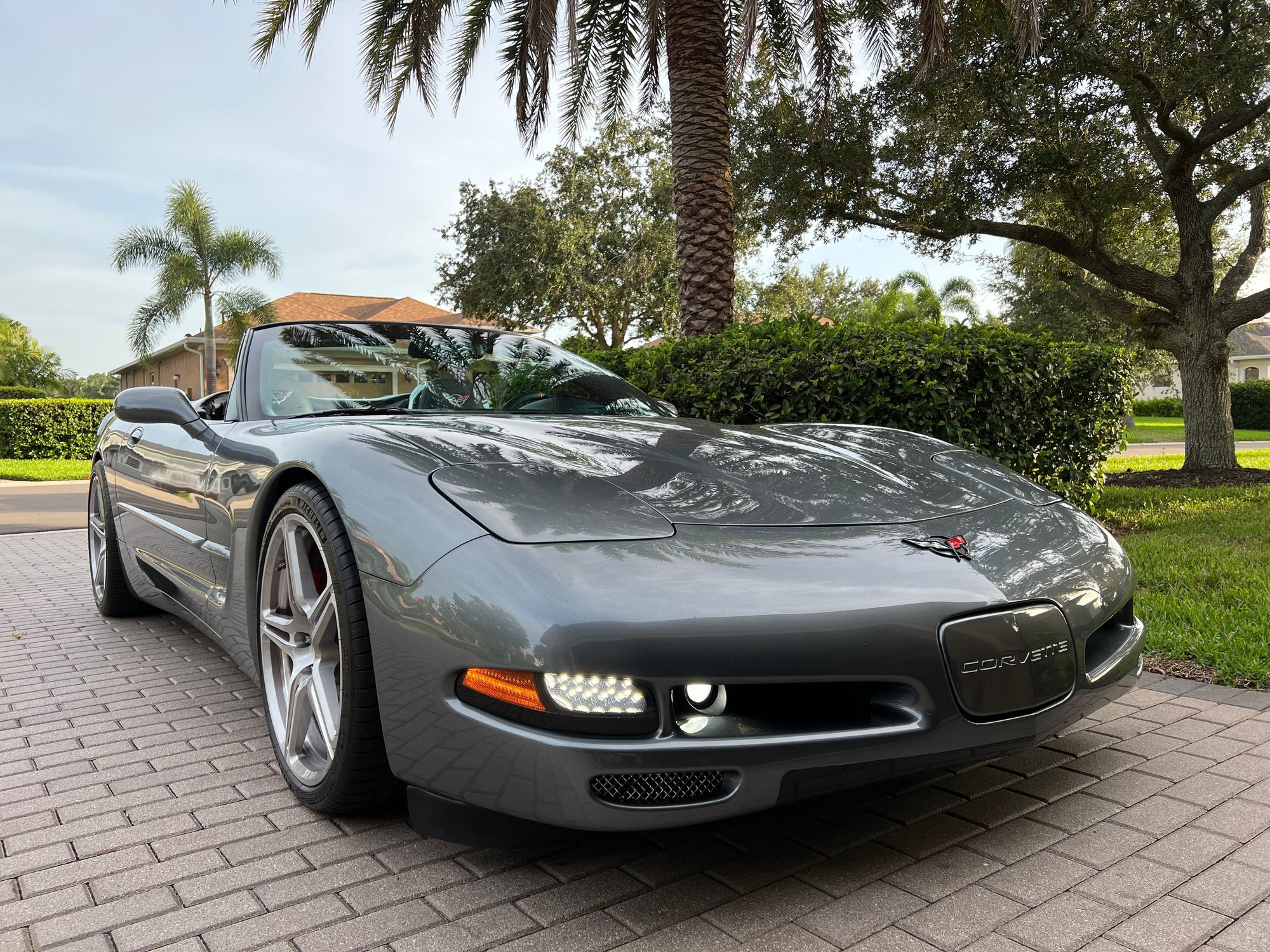

Thought about putting a front splitter on my C5 convertible.Just wanted to get some ideas and thoughts about adding a front splitter.Good or bad
