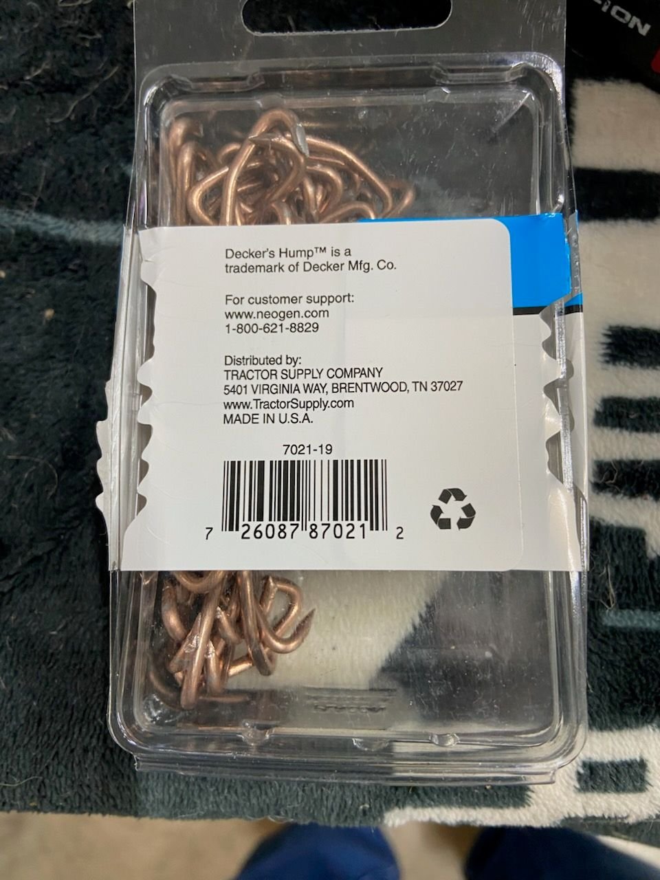

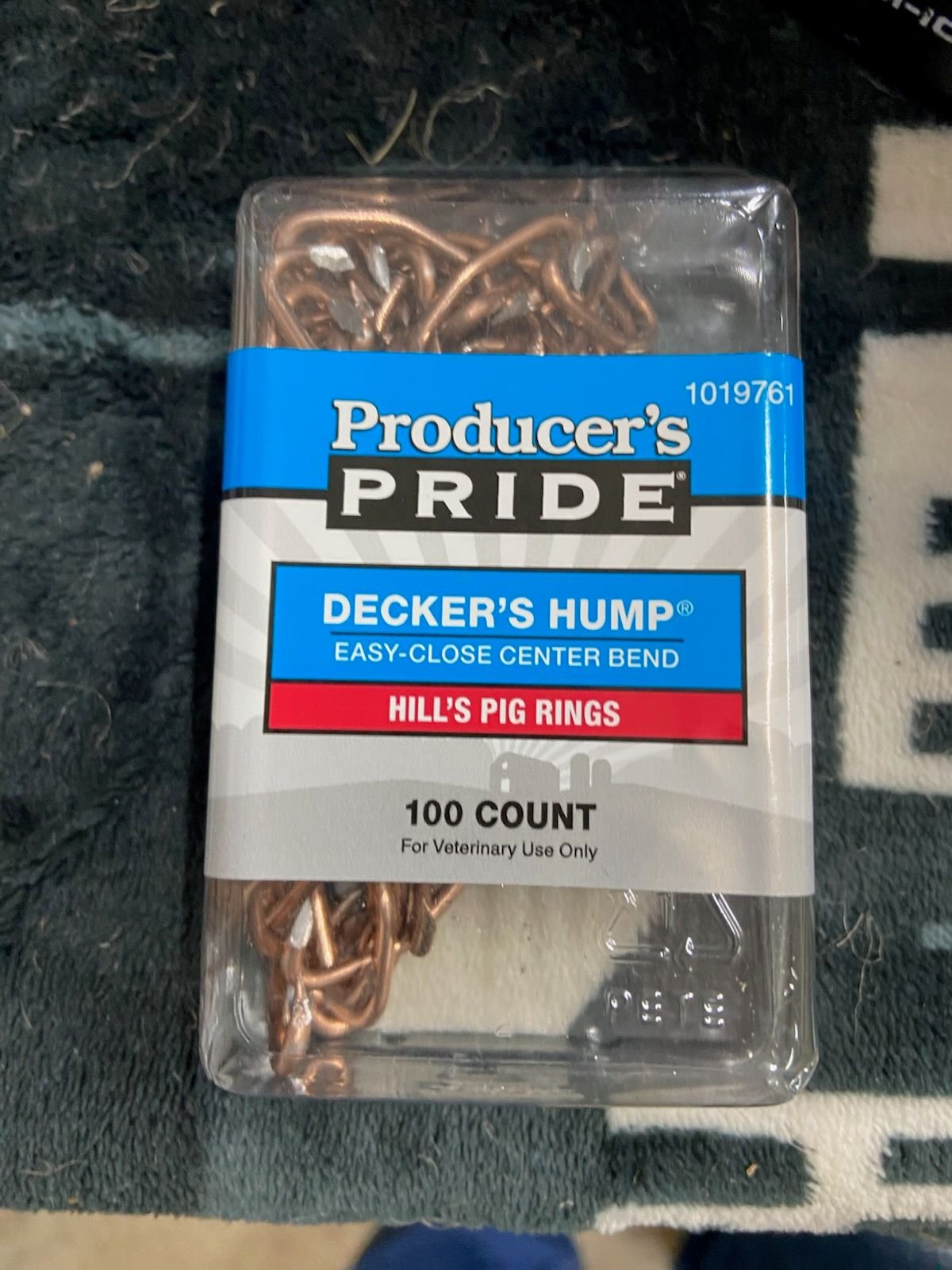

Tractor Supply has them in various sizes! I used them on the front buckets on my 1972 442 and they worked great! Better than the hog rings that Legendary sends with their seat covers IMO!

From what I've experienced from recovering the front bucket seats on my 442, I'd trust the metal hog rings longer than the plastic zip ties. Plastic becomes brittle after 10 years or more from my experience. The hog rings should survive forever unless they are in a wet environment and rust becomes a factor. But then, if moisture is an issue, you have bigger problems than seat cover attachment. And the hog rings from TSC that I mentioned above are what appears to be cadmium plated to thwart rust.
