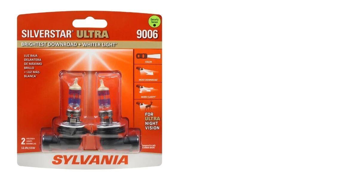

Halogen bulbs do dim with age. The easiest thing to do is replace them with new ones. I have had good luck with Silvania Ultra Star.

JCGUNN:
After much research and your recommendation I going with the Sylvania Silverstar Ultra headlamp bulbs. Looks like a little brighter light and no negative issues with lights blinking and messing with the computer. I also found out my passenger side fog light is out so they will be replaced. I checked the shop yesterday that usually works on my car and asked the cost to replace the 4 headlight bulbs and the 2 fog light bulbs. They advised $521.00 dollars. I declined. My son along with help from YouTube will get the job done.
Thanks.

Yes you would have to be insane not to change your own bulbs. You may want yo brush up and learn to do more. This is an easy car to work on.
Still might consider led later as the brighter halogen bulbs have shorter lives.
