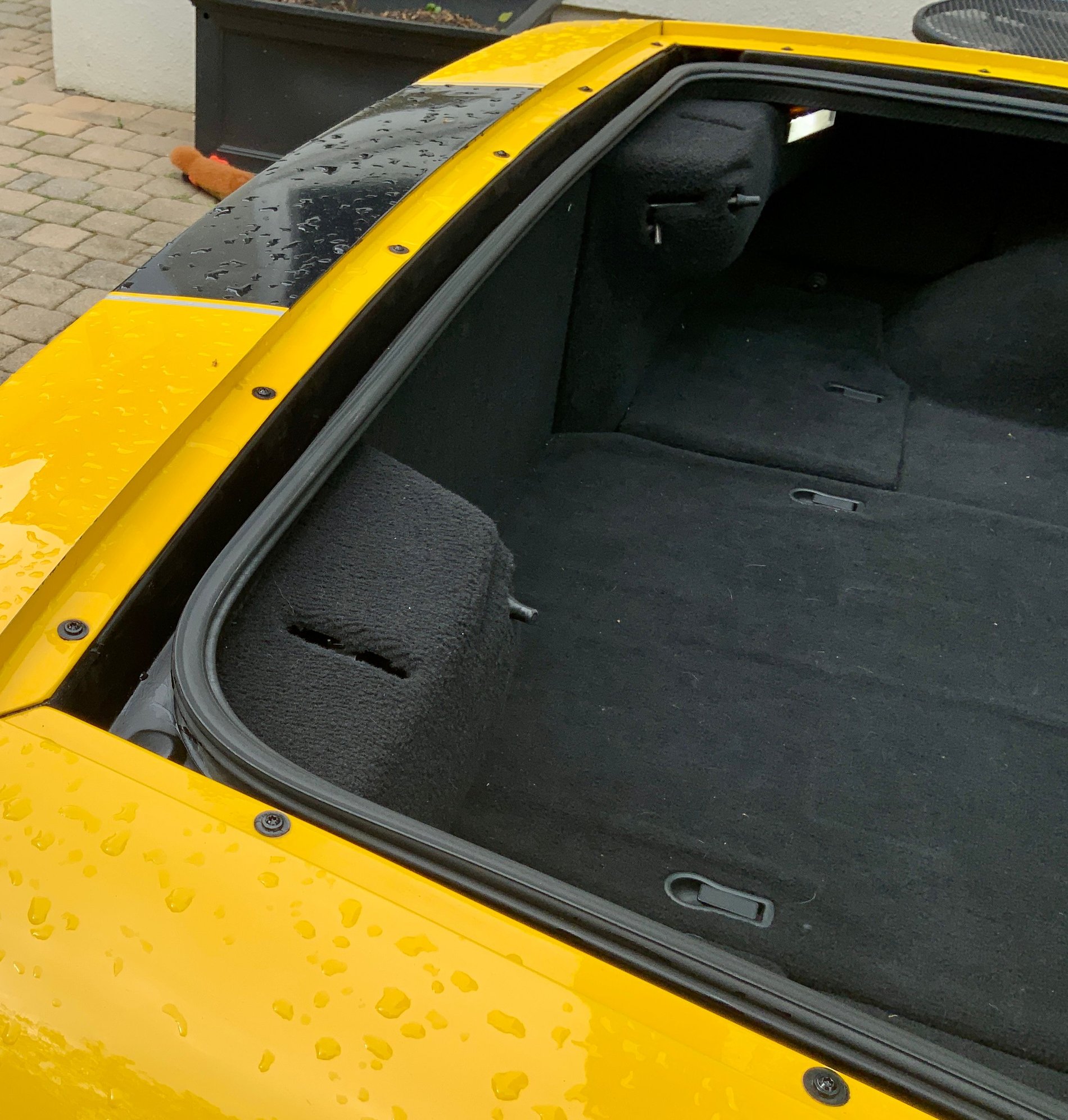

Hi Folks, I’m on my 3rd C5 but never saw this problem before. I don’t know if it’s fading or what, but no amount of rubbing gets rid of the white ‘stuff’. It sortof ‘ends’ at the targa ‘bar’. Has anyone ever encountered this and if you fixed it, what did you do? Thanks!

Looks like unpainted fibreglass composite to me.

Like someone cleaned it with a substance they shouldn't have.
I'd get some kind of black paint compatible with the composite and coat it.
I'd just brush or wipe it on.

That is weird. Can say I've not seen that extent of damage/fading there before. I'd definitely look into some kind of painting though.

I have the exact same condition. I have tried all sorts of cleaners and treatments with no help. I am now down to painting.

Not sure if I want to mask it all off and spray it or brush it on, tho’ I still would mask. However since this looks like the ‘opposite’ of a stain, I might try some kind of ‘bumper black’ first.

Bumper black is one of the treatments I tried. The surface seems really hard and may not allow anything to soak in. Before I paint mine, and I will spray it, I am going to try lightly sanding a small spot and see if that helps something like the bumper black.

Looks like someone has used paint stripper on it. Any previous damage or panels/bumper replaced?

I would use what we call "rocker guard"... rubberized rocker panel/undercoating, brushed on.

In any of my three C5s I never had that area look like that. It does almost look like something took the finish off that area. Maybe check with a good body shop that has experience with Corvettes and see what they recommend.

I finally tried ‘bumper black’, it basically did nothing. Next is a thorough cleaning and black paint.

Satin Clear
After adhesion promoter
Should retain the original look

My 2004 Vert had this issue when I purchased it. Like above, I tried cleaning it....that did nothing. Tried a light sanding.....nope. Tried "Back to Black"...another nope. Then I found "That Black Stuff" satin black trim restorer.....YES!!! I did washed the area, let it dry for a day...does not take much time for water to evaporate here in Tucson....anyways, applied painters tape to the body, removed the truck lid, removed the screws along the sides.
Then it is just a matter of using a small sponge or rag to apply this stuff....WEAR GLOVES..... I let it dry and applied a second coat, which did not make much difference. Looks brand new again.
I put all of this into a thread when I did it a couple of years back. Seach for my name, you'll find the pictures.

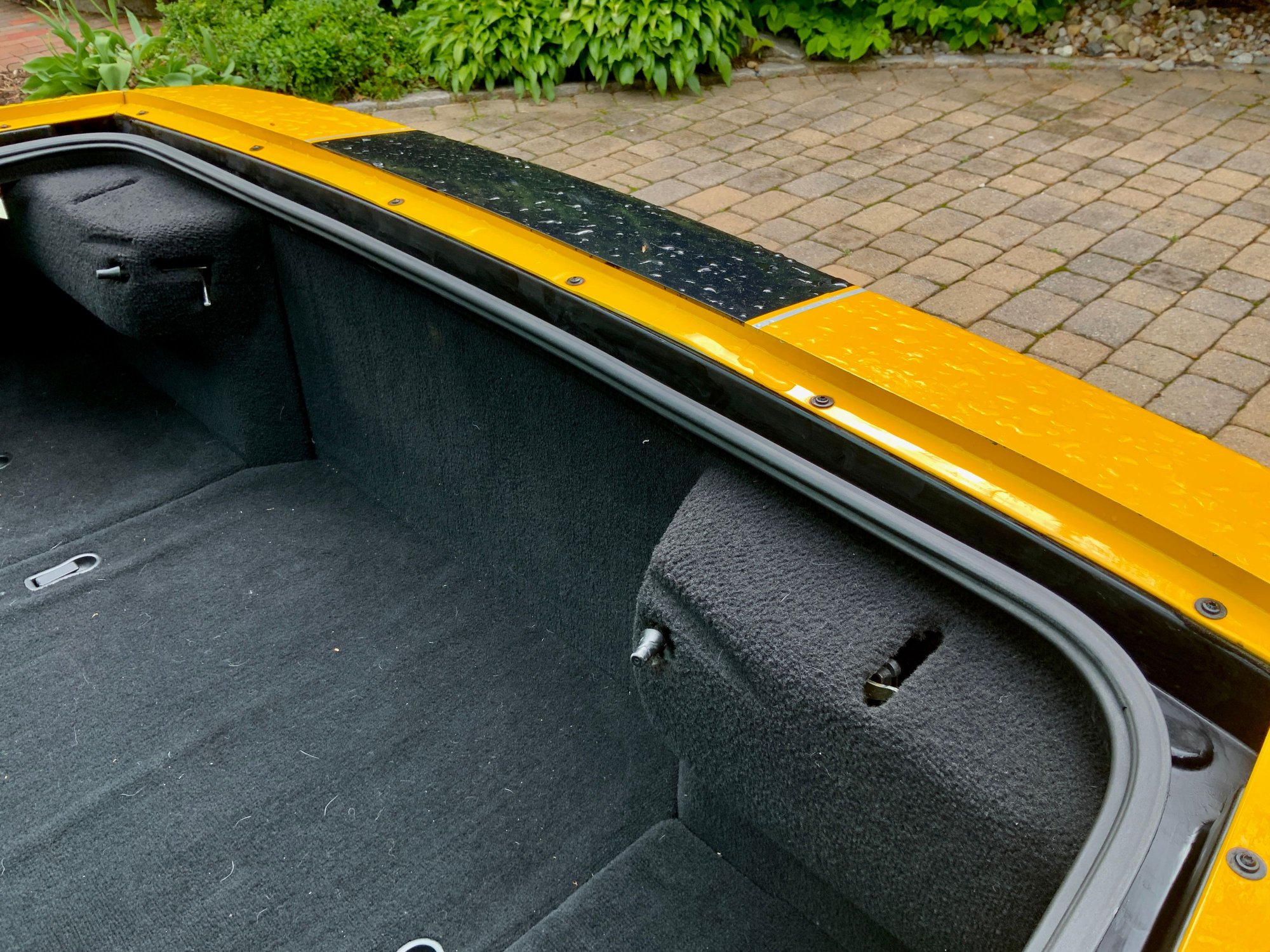

Thanks folks. After trying one of those “Back to Black” products with no results, I decided to paint the area with satin black . I think it came out pretty good and it no longer shouts ‘WTH happened to that plastic?”

Definitely looks much better. 😎👍
