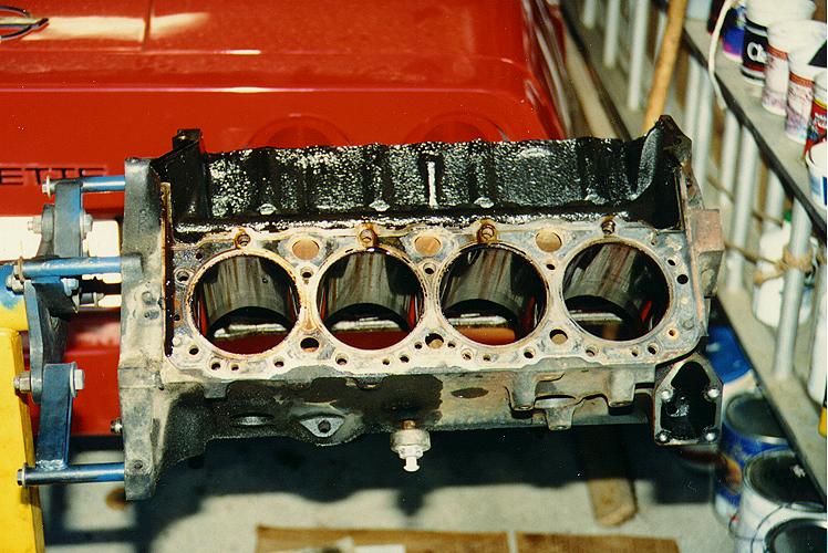

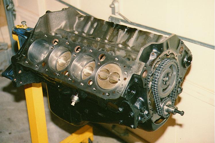

Inspect the entire engine to find the exact problem, or to look for additional wear/damage?
Both.
If you do plan to keep the car for a long time then I would want to be sure that the issue with this motor is really fixed. This is a high performance motor that is going to be revved high quite often. I would not want excessive bearing clearances or possible cylinder damage & blow-by.
I would not surprise me if they could pull a rod with the motor in the car, but if this was my car and I would prefer a complete inspection. I am not sure if the dealer would actually comply with this request. It would be a shame for them to swap a piston assembly with the motor still in the car and then have the car come back with additional problems. Hope it work out with as little hassle as possible. I would do this: :)
Click images for larger view
