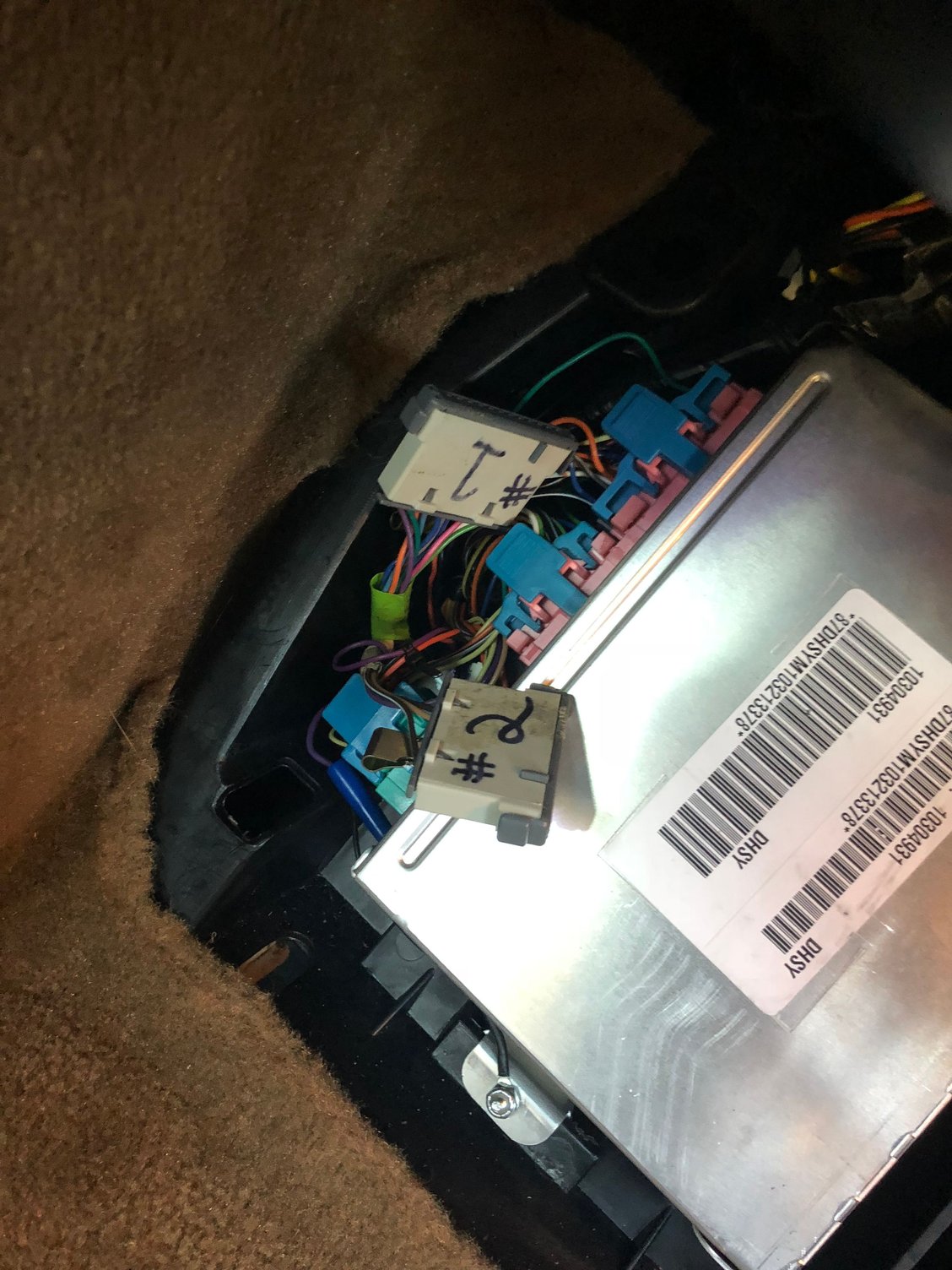

I get off work tomorrow early so I'll try that out. Were your pictures taken after you took it out?

It's a 1999 c5 with just some exhaust. I'm just confused where the carpet is coming from since the pcm is in behind the passenger side front tire.

It’s BCM (Body Control Module) and not the PCM !!...BCM is at the passengers side footwell. This is the wiring from my ‘01...yours should probably be the same....as you can see the BCM and IPC are fed from the BCM1 and IPC fuse 25...if you have a voltmeter you can do a “voltage drop” check across the ignition switch...with the engine running take your voltmeter red lead and connect to battery positive...connect the black lead to one of the test points on top of that fuse 25....read the voltage
drop...you shouldn’t see more than .1 to .2 volts of a drop...try that and also the drop across fuse 23 (BCM 2).

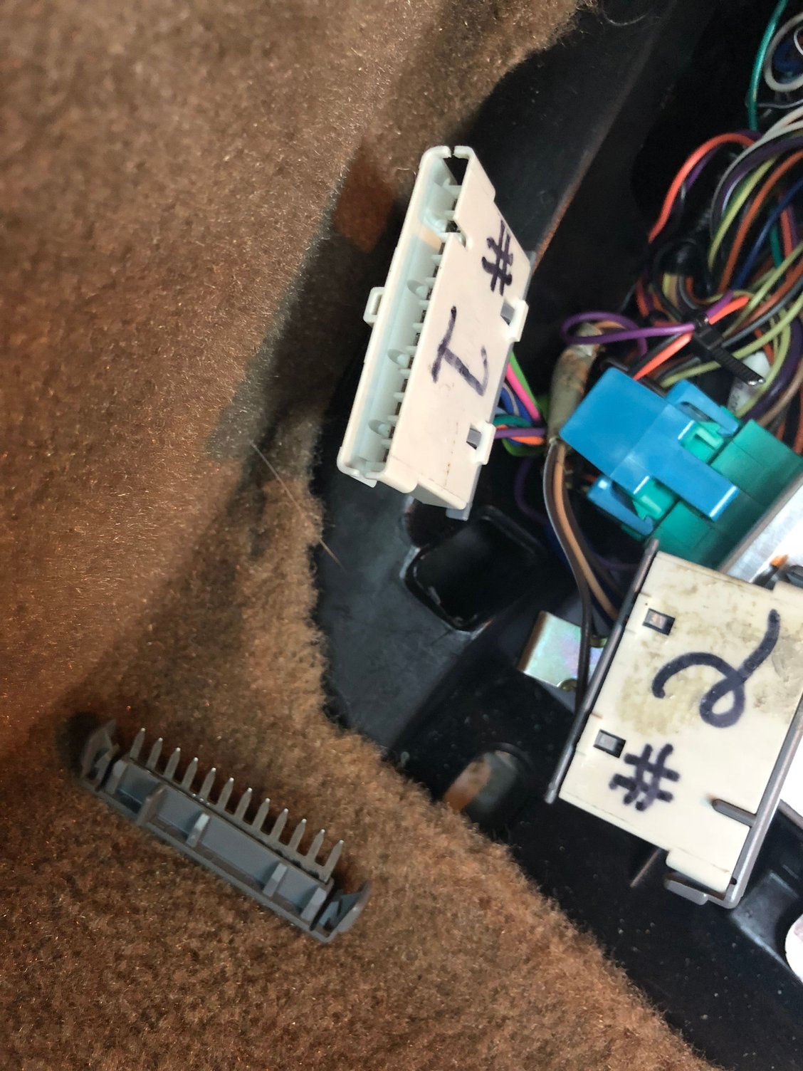

One of my combs did not come out with the plastic, it was still stuck inside the part where the wires are. Could that be a problem??

Happened to me too !!...just get a pair of needle nose pliers and yank it out !!... the comb basically ties together all those wires !!

Check and see if you see any corrosion inside...being inside the car it’s not as bad if it were outside the car. I have a terminal cleaning kit that has super thin files that you can clean those terminals with...I use a small wire brush on the combs...sandpaper will work too...just get it super clean !!...you just have to pop the plastic piece back onto the comb !!

Its all good now, and just in time for the weekend. I really appreciate it c5 diag. Definitely going to have to check your you tube out and follow it. Made my week to get my dash not to look like a Christmas tree and having to press reset 5 times to clear it every time I get in the car. Off to long tube headers and a tune.
