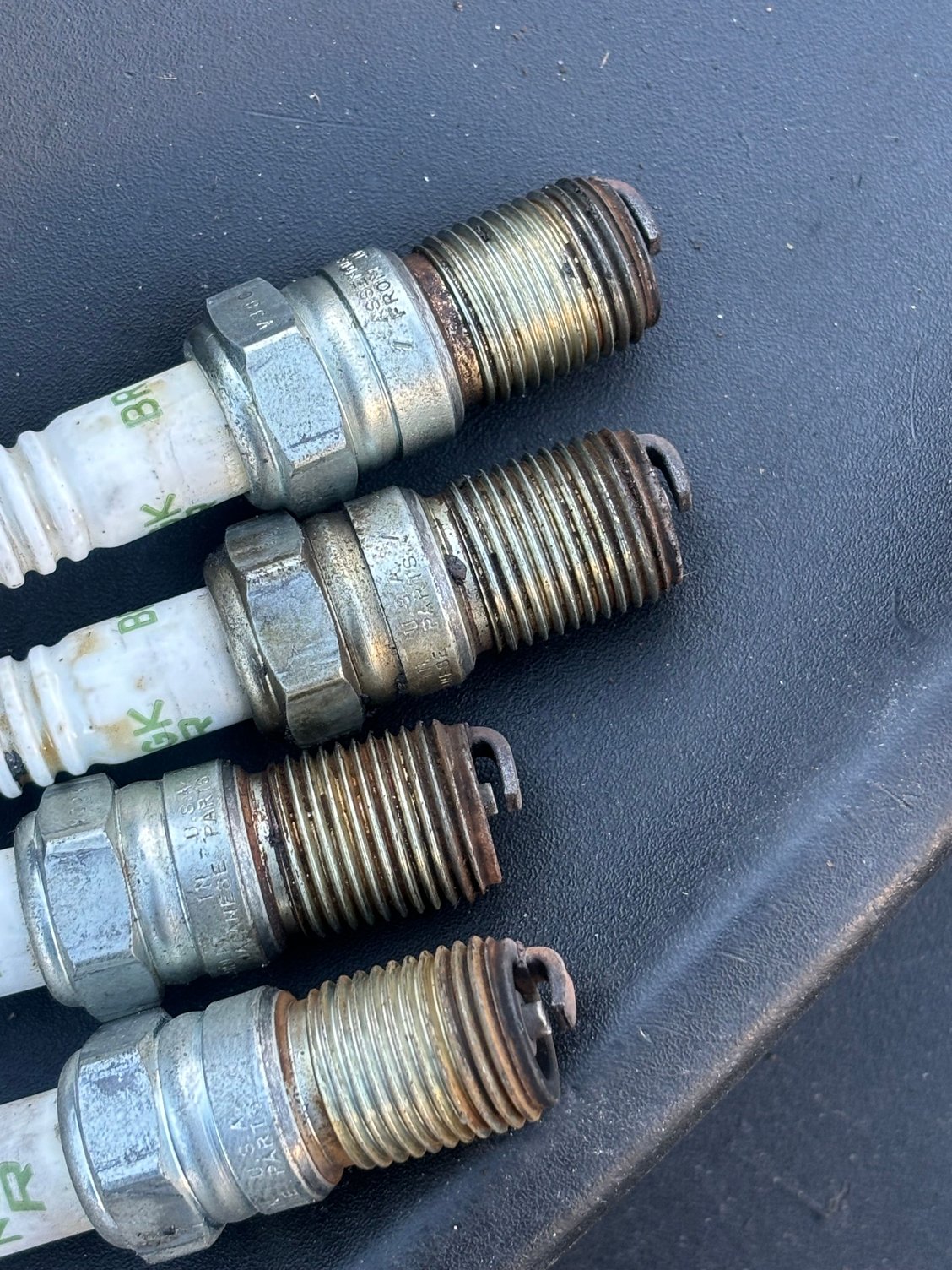

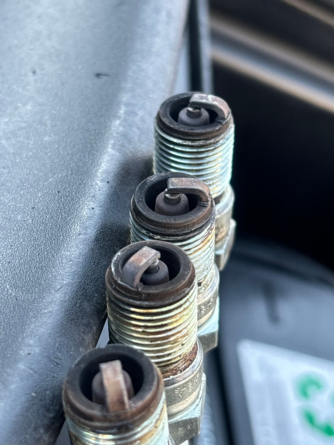

Pulled the plugs and this is how they look. These plugs were originally ran with nitrous too on normal 93, don’t know if that makes any difference in how they look.
Bank 1
Bank 1
B1
B1
Bank 2
Bank 2
B2
B2
B2
B2
Old Jan 22, 2025 | 07:42 PM
  #60
helga203's Avatar
helga203
Joined: Jul 2010
Posts: 6,013
Likes: 726
Originally Posted by aaronc7
The biggest lesson to be learned here is properly wire up needed sensors before you try to tune something. Fuel pressure and especially wideband for this one. Plus who knows whatever else hardware issues going on.
Yup,
