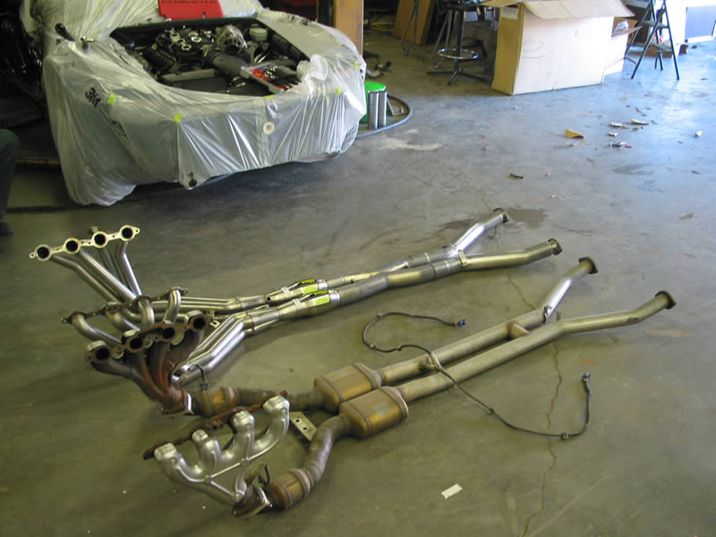

Sort of off topic but related to my original request....can someone provide me with a picture of the underside of a roughly 98 C5, specifically showing the STOCK exhaust system? I want to make sure mine is stock and I am not sure....
Can't help with the pix but if you have a "one piece" center section from the factory exhaust manifolds back, then it is probably stock. By "one piece" I mean that everything in the "center section" is welded together. No clamps anywhere. Also, if your crossover is in an "H" configuration, it is probably stock. Remember, it is possible to change out just the rear portion of the center section and install an "X" style crossover after the cats. The exhaust manifolds themselves of course will be rather obvious if they are the stockers.
If you're going full boogey on the headers etc, I would recommend getting high flow cats with whoever's x-pipe that you're buying from.
BTW, the install on the header can vary a little from brand to brand, but it is not uncommon to have to raise one side of the engine (a little) at a time in order to install. It's not necessarily difficult but can be a little on the time consuming side since you're removing various accessories such as starter, alternator, spark plugs, ECT sensor, steering shaft coupler, etc. HTH

Don't be messing with headers, get those headlights done! Anyway, here is a 2001 Z06 factory system beside a LG system. Your converters and manifolds may be a little different but the H pipe should be close to this. If your going to do headers get you a set of LG and try to improve on those. They seem to work really nice and lots of people has gotten really good numbers on the dyno with them. Make sure you use 100% stainless steel. I was disappointed in my LG when I found out the AIR tube flanges, O2 bungs, and rear flanges where not stainless. Well, they may be a really low grade of stainless but a magnet sticks to them and they do rust so I think they are plain mild steel. Also, good quality is important. Again I was disappointed with the welding on my LG headers. I know stainless is not easy to weld and I'm no welder but I'm sure I could have done a better job on most os the welds on my headers. Maybe the guy welding was new but there was places where they blew through the pipes and just welded them up and ground them down leaving them kind of patched up looking. I was really impressed with the fit and easy install of the LG system and they do sound good!
Good luck! And get those headlights done!
Thanks thats exactly what I was looking for. I am working on both as fast as I can. I will have pics shortly.
