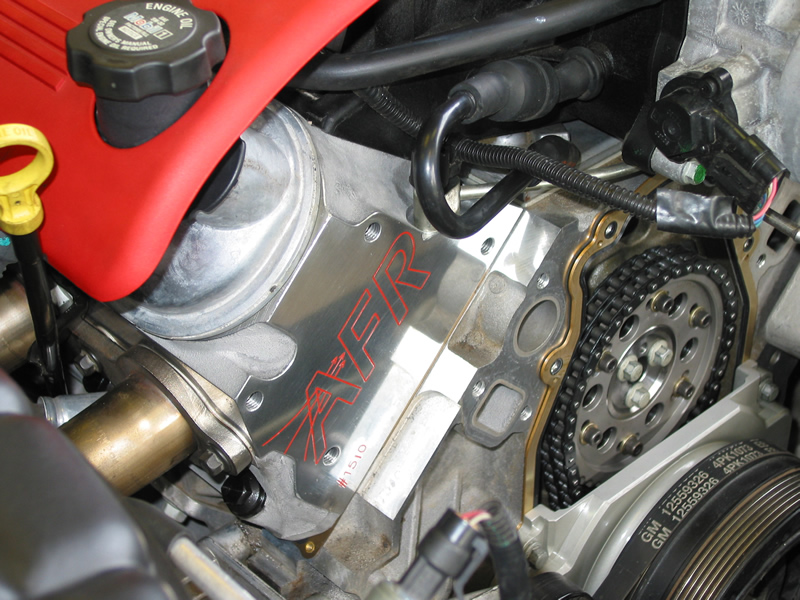

Tony Mamo @ AFR's Avatar
0Tony Mamo @ AFR
Former Vendor
Joined: Mar 2004
Posts: 1,518
Likes: 7
From: Valencia CA
I recently installed the QTP unit on a 383 LS1 I just finished dyno testing (results coming soon), and I have to tell you it worked flawlessly, looked great, and saved me a crap load of time swapping cams on the dyno. The fit and finish was excellent and it looks the part. I will never build another engine (that I plan on testing) without one. Assuming you are looking for a situation that helps make cam swaps a breeze, it is definitely one of those "must have" options. I think the looks alone (all billet) are worth the difference versus the modified stocker....at least at the current "spread" between the two. Seems both are capable of getting the job done, however, which is obviously the most important aspect of the purchase.

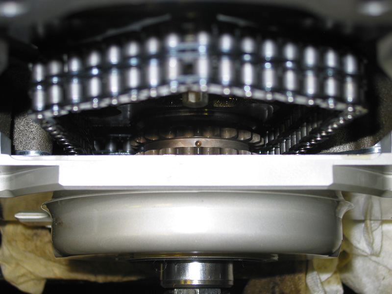

Yes they will , I'm running the QTP cover with a top adjustable double roller chain, but be careful, PM me if you need details. End result is you can simply adjust the cam, and/or replace the cam, and run a double roller chain! A double roller chain will NOT work with their HV oil pump.
It is easy to see the timing marks if you add another dimple to the lower gear. I simply sit the gear in the drill press and made an extra dimple between the two gears and in front of the factory mark both facing up. Here you can see the one between the two gears. The gear is massive with the oil pump drive built on, it won't weaken the gear at all, and it only takes a very little dimple to make it easy to see.
