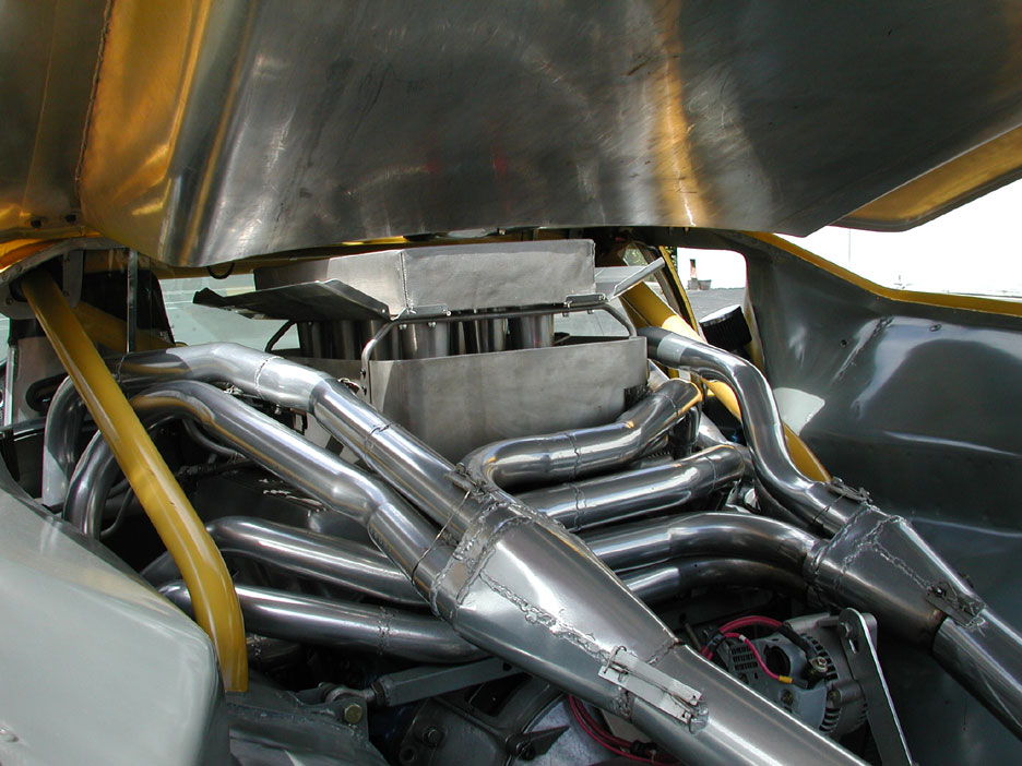

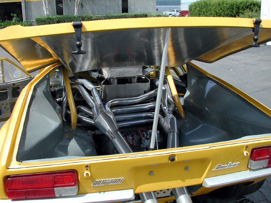

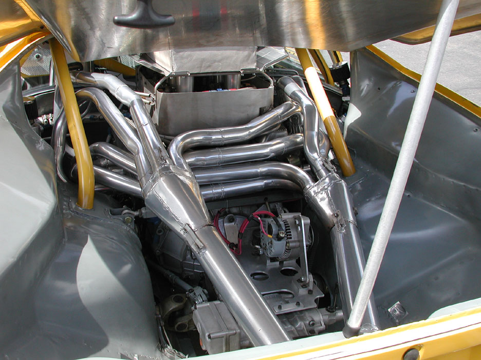

Originally Posted by aggie_corvette
Ah yes 180 headers. We use them on our panteras.
http://www.panteracars.com/engineDscn1009.jpg
http://www.pim.net/bgDscn0617.jpg
http://www.pim.net/bgDscn0618.jpg
http://www.pim.net/bgDscn0620.jpg (not mine)
we always called them "bundle of snakes"
They work on mid-engined cars very well as we have the space.
another pic
http://www.erareplicas.com/gt/img/exhaustop.jpg
(same engine different car, gt40)
I'm suprised somebody made them for a vette. I looked and just can't find enough space to route all the tubes and still keep them at 32".
They definetly change the sound of the exhaust.

180 degree headers have been around since the late 40's... Headman headers, and Hookers were everywhere in the 50's and sixties. 180 degree headers are simply designed to produce the correct back pressure and scavenging. Getting 180 degrees from each tube and to the collector in more sophisticated cars has always been the challenge..
