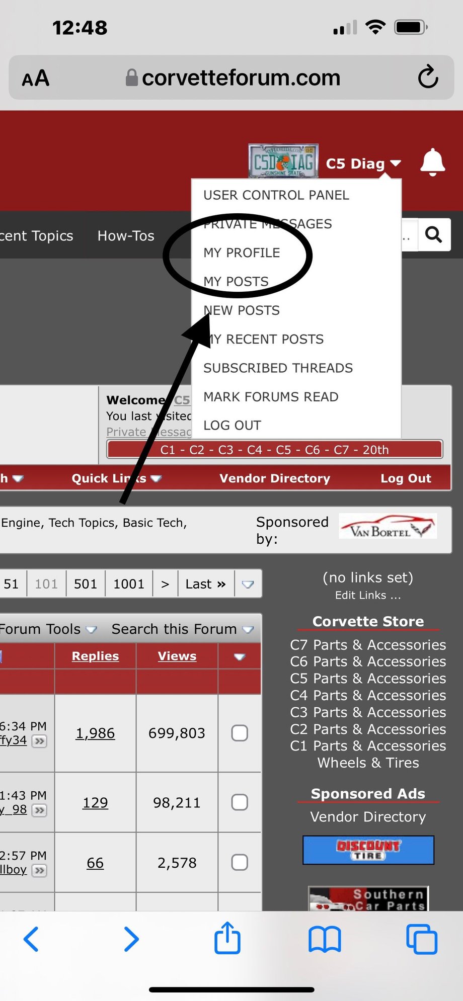

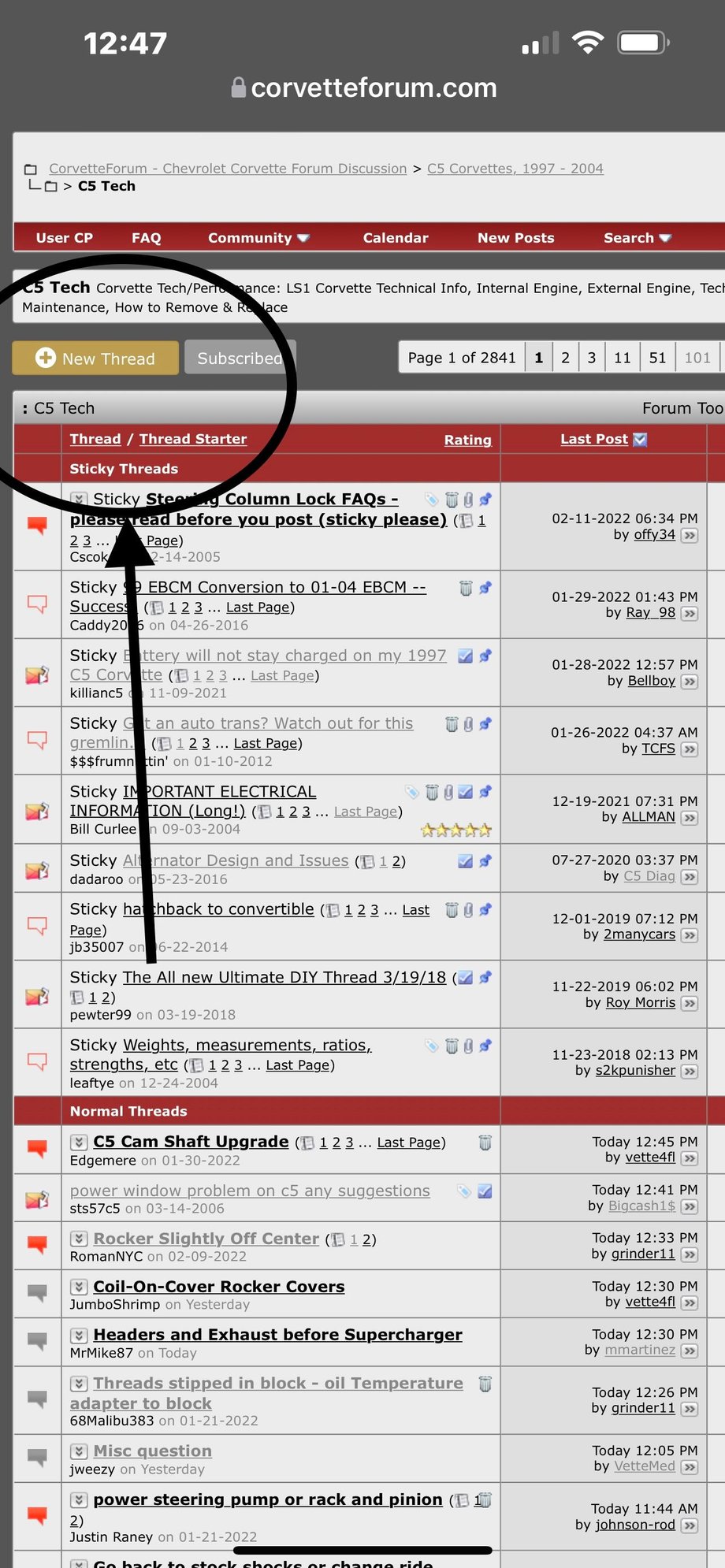

Click on “C5 Tech” and you’ll see “New Thread” as in the picture and if you click on your username in the upper right there is a drop down for “My Profile” !!
