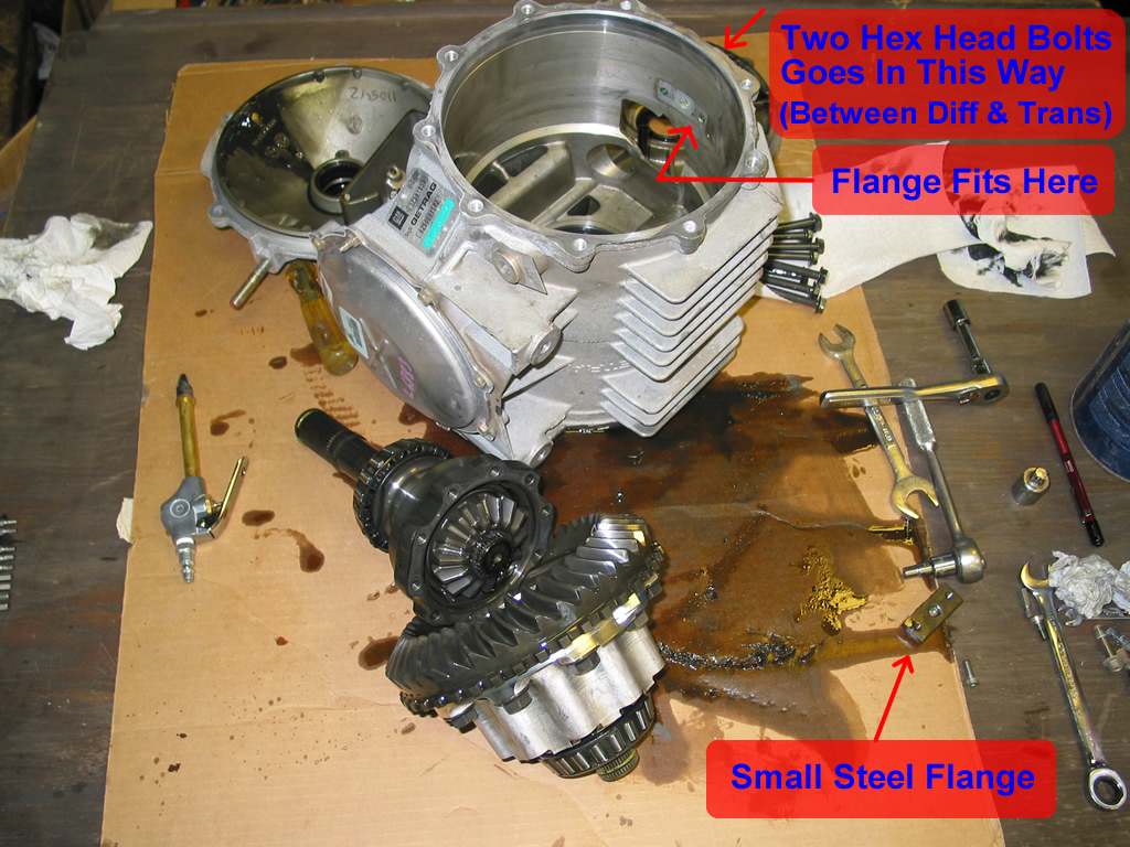

No you can not, the entire diff must be removed from the car because of one small steel plate that is bolted in place with bolt from under the trans side of the case. The bolts can't be removed before you remove the diff from the trans. This plate prevents the ring gear from coming out the side cover so no way to get the carrier out without removing the plate first. Below is a photo showing the plate and how it is bolted into the rear diff.

SpeedyZ... that's quite a revealing pic you posted. Hope you don't mind that I right-clicked ... saved-as ???

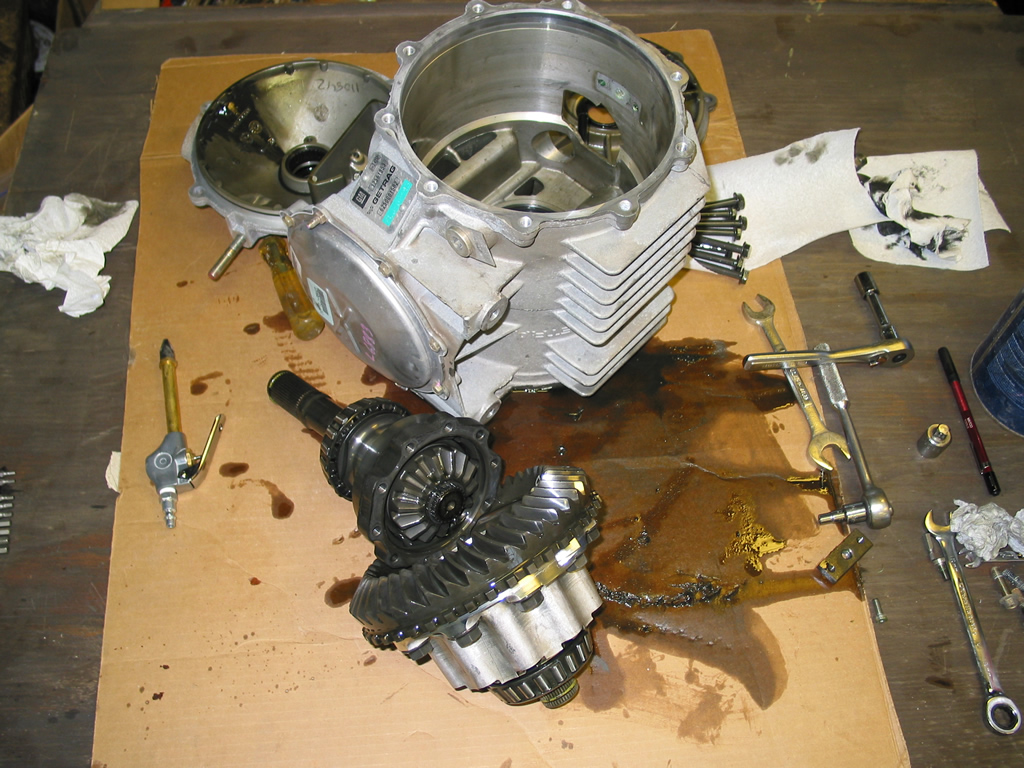

No problem, here is the same image without all the captions. I didn't take too many photos while working on the diff, I didn't have anyone else to take photos and after working on the diff for a few minutes I was not going to touch my camera! I didn't want to go wash up every two minutes either! So I only have start, middle and complete. Obviously this photo is the middle!
