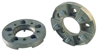

Spacers reduce the amount of thread that the lugnuts can grab - thus weakening the grip. However, here we are talking about hub adapters. The adapters actually bolt on to your original hub just like a set of wheels would. Then they have new studs that are used to attach the wheels. With these, you do not have the loss of grip.
Like this.....

how much? and where can i find these hub adapters? certain types better than others?? love to hear from anyone that has spacers and hub adapters and their thoughts. And i have order the OEM chrome c6 wheels with the stock run flats that come them.got a great deal,considering im from vancouver, BC

Don't know about pricing, but try summitracing.com
