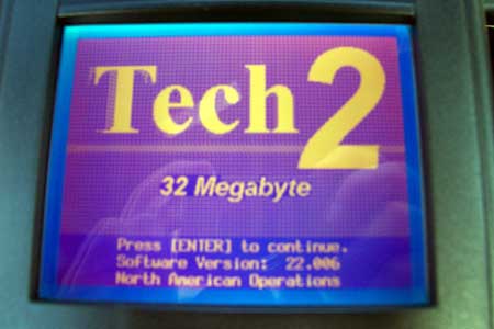

I believe that the "Crank Position Relearn" procedure requires the use of the Tech II device. Useless the crank has actually been removed, there should be no need to do the procedure for swapping out the PCM. Granted that PCM with have to learn its new setup( LTFT, idle relearn, and so forth ), but all can be done without the need of Tech II.

efi lived pro cable can do this.

Actually, You only need the scanner to do this. I think EFILive version 6 also has this.

Ahh, if you've replaced the PCM then yes, you need to do this. It's called a CASE (Crank Angle Sense Error) Relearn, CKP Learn(EFILive 7.0+, EFILive 5+ (with Pro cable?)), or Crank Position Relearn. I t can be done with a Tech 2, or EFILive 6+. I'm not sure of other products available for this.
Yes, it's the main way the PCM detects a misfire.

I just had my PCM replaced and had to do a crank position relearn after. There may be other ways of accomplishing it, but the shop used a Tech2, set it to the appropriate menu and then floored it twice while idling in Neutral - POSITION SENSOR LEARNED.

Any scan tool with the enhanced GM pids and a bidirectional cable will perform the CASE Learn. Anytime you replace the PCM you need to have it done. Another alternative is an Auto Labs type of shop, they usually charge $30-45
