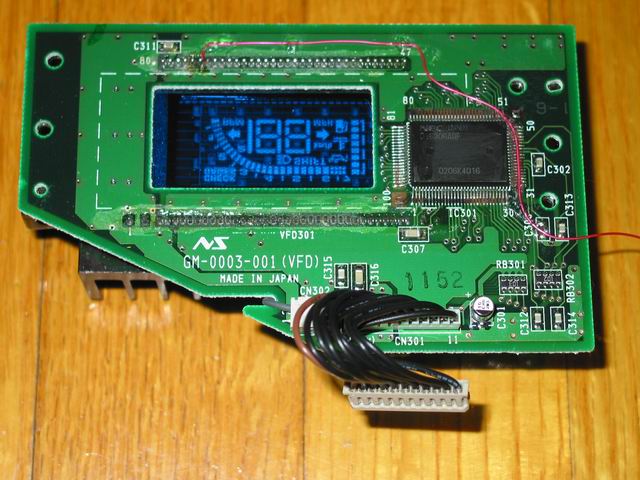

Yep, its the sun. When light gets shined in at just the right angle it will light up the display giving you what you seen. Below is a photo of the HUD display, as you can see is is blue in color, once light is shined into the display much like the flash in this photo the entire display will light up. There is actually two mirrors in the HUD so there is a few different angles which will cause this. Some times if the light refracts you will even see strange colors.

what's going on with the extra wire there?
That extra little wire is the trigger for my extra LED shift indicators. That is attached to the SHIFT segment on the display, any time the HUD turns on the SHIFT segment my circuit turns on the extra LEDs.

Normally the HUD display will be chopped off as it reaches the top, (at least for us tall people). You should be able to us a flashlight and look down in the HUD through the windshield and look over on the left side. I think you can see those switches from outside. Looking at the photo Connecticut posted the switches are top 1/3 and just right of the center. There is two small switches with two wires attached on each of the arc shaped slot, the slot looks white in the photo. If you notice there is a little tab sticking out in the middle of the slot, this HUD is set about half way top to bottom. This tab will move from one switch to the other as you move the HUD up and down. If you can see the switches see if they go all the way from one switch to the other. If they do then the HUD is working properly, if not then it is probably sticking or binding. Should be really easy to fix once you remove the HUD. If you can't see the switches from outside you might be able to compare the mirror angle to another C5 if anyone else near you has one with a HUD.
