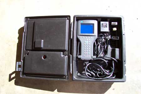

3. If it really bothers you, find a competent mechanic, and have her turn it off in the BCM module using a Tech II.

You can't turn off 1997 sensors. They didn't put the turn off into software until the Z06 came out (it had no sensors).
In that case, I stand corrected.
I thought the BCM was the same.
That means, we're back to living with the message.
