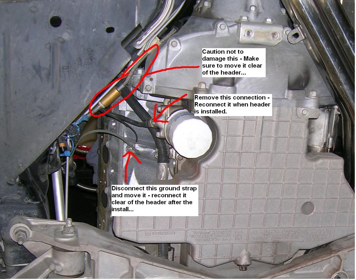

I did it myself - it's not hard, but you must pay attention, go slow, and stay organized.
The Headers came in 2 little trays - i used one tray on each side of my car to keep bolts and items (O2 sensors) from driver or passenger side seperate so i wouldn't be confused putting things back together.
Also, I accidently damaged a clutch line that cost me $900 to repair... i'd suggest you don't do the same... heres a pic i made...
Any questions just post here, lots of people have done these and can help.
As for gains - i haven't had mine tuned/tested yet because i've got H/C package en route. But my tuner (who is a Dynatech Vendor also) says he normally sees about 25rwhp after tune on these.
Good Luck
Good Luck
Dan
hit it right on the head, i broke the oil sensor there, by not removing it. oh well. i learned. it was cheap to replace but you dont want to damage the connector. also make sure you get the car high enough for the drivers side. oh and the air tubes are a pain. One is easy because you can just drill out the whole, but the passenger side doesnt come out so its harder to deal with.
