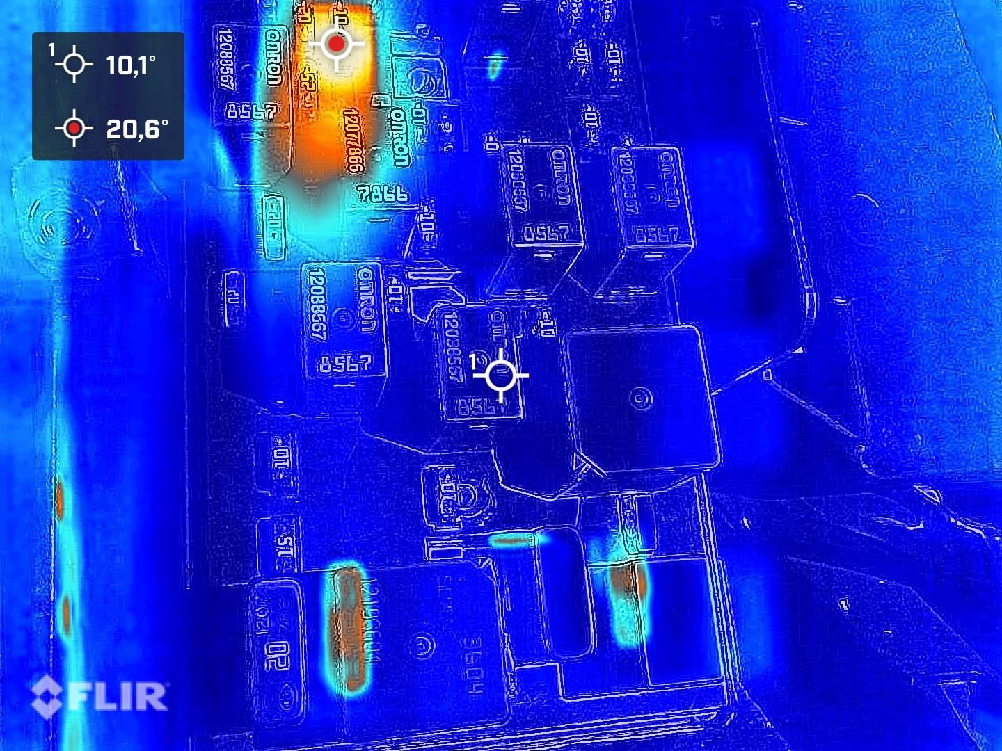

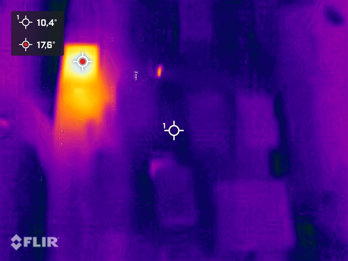

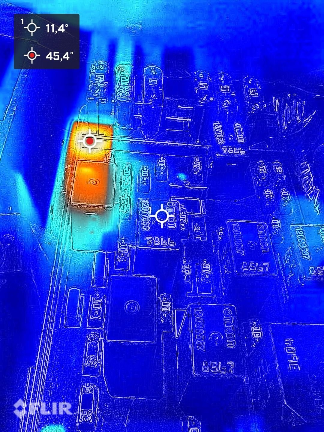

Tried to diagnose a parasitic loss. It looks like the relay 37 in the foot well is hot. Does not look like it is switching off the load. I have a OBD2 dongle, and it looked like it is powered even if the car is off. Should I change the relay? Right now I just unplugged the OBD2 dongle, temperature reduced…
