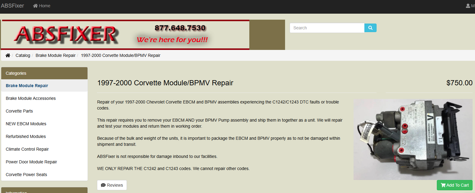

Originally Posted by lucky131969
That all depends on the DTC code.....
1242 and 1243 are codes not having anything to do with the electronics of the unit. One is a ground issue, the other frozen ABS pump motor. While those can be repaired the actual EBCM electronically cannot be repaired. This is why the two codes they can repair, the mentioned ground and motor faults, are in bold letters. If you're showing C1255 which is internal malfunction, or in other words The Kiss of Death for an EBCM. I have a 2000 with this code, believe me if it could be fixed I would have been on it long ago.
