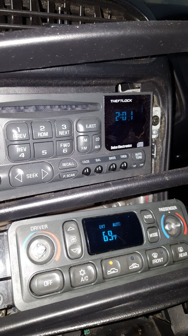

Same. Was out there working on my mystery extra white wire/parking brake setting off my alarm issue. Didn't want to put this off any longer, so turned on my soldering pencil:
Seriously easy. The hardest part was one of the resistors was loose on the opposite side of where I was soldering so it slipped away and it was a slight pain to keep it in place. If you can solder you can do this.

Thanks to forum members this is an easy fix. The console comes off easily (if you don't force things).
I used a fine tip on a regular soldering iron and fine solder. Most of the connections looked good but, while soldering one end on a 241, the thing moved...the other end was not "soldered".
The whole ordeal, start to finish, took 2 hours...and I'm old and slow!

So winter appears to be over here in Kelowna BC, my BMW winter car is sold, Z is insured and drove it to work starting this morning. Display is beautiful, looks great.
Standard background lighting however, completely out. Yes, the dimmer is up, radio and dash have lighting.
Could there be a bent pin or something on the rear? Don't really have time to take it all apart right now, but next weekend I guess...
