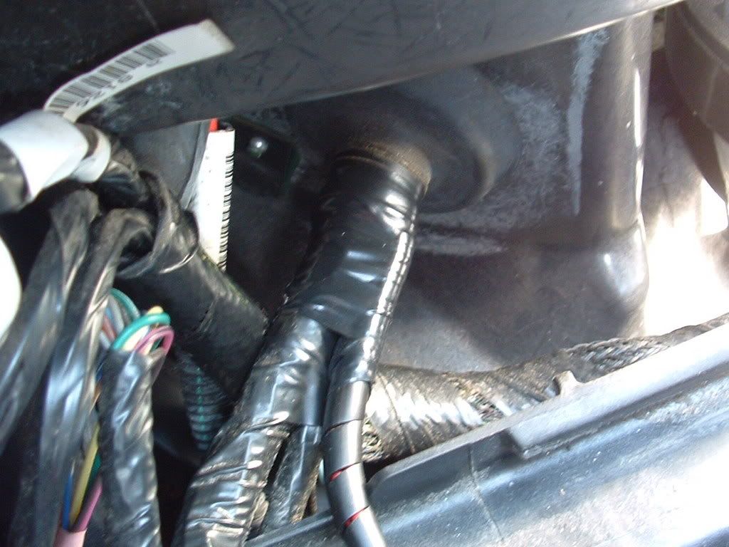

where did you guys run the power wire through the firewall? thanks.

Thats an EASY question that even I can answer!!
Theres a BIG rubber fire wall gromet behind the battery area. You can insert a wire fish tape in that gromet and fish a wire in there!

Old Feb 12, 2007 | 08:54 PM
VFRLuke's Avatar
VFRLuke
Joined: Jul 2002
Posts: 320
From: Jeffersonville IN
that grommet is a tight fit but works great. I pulled 2 4 guage wires through it and just figured I'd tip you off to put a little bit of grease of the wires when feeding them through. Helped me a LOT.
