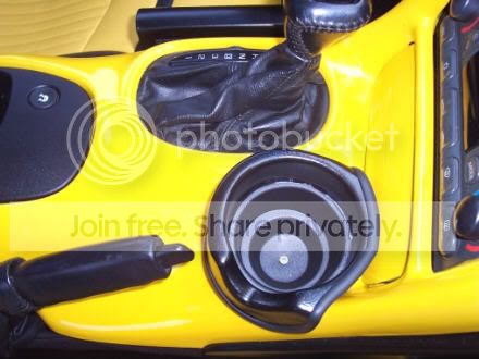

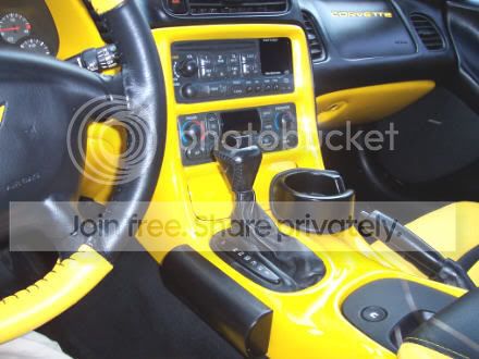

Default CUP HOLDER LID REMOVED.. New modified cup holder in.
REMOVAL OF LID:
Open the lid, and notice at the bottom sides there are two tiny pins holding the lid on. a large one with a smaller one going right into it.
I was actually able to remove the 2 small center pins with my finger nails. The two larget pins needed a little help.
I used a small flat head screw driver to pull them out a bit and then used needle nose pliers to pull them out. The lid then came right out. Very east removal.
I had previously purchased a double cup holder from corvette central, but I didn't like the way it stuck out on the passenger side. After some thought, I decided to modify it into a single cup holder. Using a Dremel tool I was careful not to cut it to narrow as I wanted the surround to just miss the lighter/ashtray door because I'll be installing a satilite radio in there and also it had to butt up to the outside edge of the console on the right. The opening that was created when I cut the cup holder in half had to be facing the rear so I had to rotate it and recontour the bottom edge. I then took the rubber trim that I carefully removed from the origional holder and put it onto the now single cup older. Lastly I drilled a tiny pilot hole into the console cup holder opening and another into the center bottom the the cupholder. Took a 3/4 inch long flathead screw and attahed it for a solid fit.
I finely have a cup holder that I like and I think looks great. I really like how this mod turned out.
[IMG][/IMG]
[IMG][/IMG]
[IMG][/IMG]
[IMG][/IMG]

Old Feb 15, 2007 | 04:09 PM
Roc87
Guest
Posts: n/a
Looks Great
Who painted the console for you?
