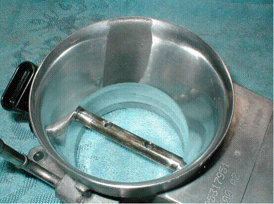

Mike, you are a handy guy.. do it yourself and save the money.. I did mine a few years ago and kept the writeup. cost me a few bucks in materials assuming you already have a Dremel... Mine looks as good as a Shaner..
Let me know if you want it.. I will email it to you..
I'd say if he was just polishing it, yes, you could do a great job yourself. But the amount of material removed really requires a lathe to do properly. You can get a "satin" finished one for $129 shipped and polish it yourself if you want to save a few bucks and you have a little time.

I did a little more than polish it ... and it does not require a lathe if you have a steady hand and patience with a Dremel.... Here the finished product before I put the blade back in.. I relocated the PCV system because I did not want ANY interruption in airflow by drilling a hole in the filled area.. Sorry for the crappy picture quailty.. I only had a low res shot on my PC..
You can download my Instructions here.
http://bellsouthpwp.net/c/b/cbosco/T...ody%20Port.doc
