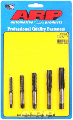

A tap will remove some of the aluminum. You should probably try to find the specific size thread chaser which will clean up the original threads w/o further metal removal. They look like a tap with cuts in the sides.
But, if the damage is already done, you might have to install a HELICOIL or similar metal coil thread repair insert.
SUMMIT RACING has several sets available, use keywords "thread chaser".
Here's a set of ARP thread chaser tools...
Clean those dirty threads.
These ARP thread cleaning chaser sets are designed to clean dirty holes. They include the correct thread pitch and diameter for the most commonly used threads, and their 3-flute design offers added strength.
