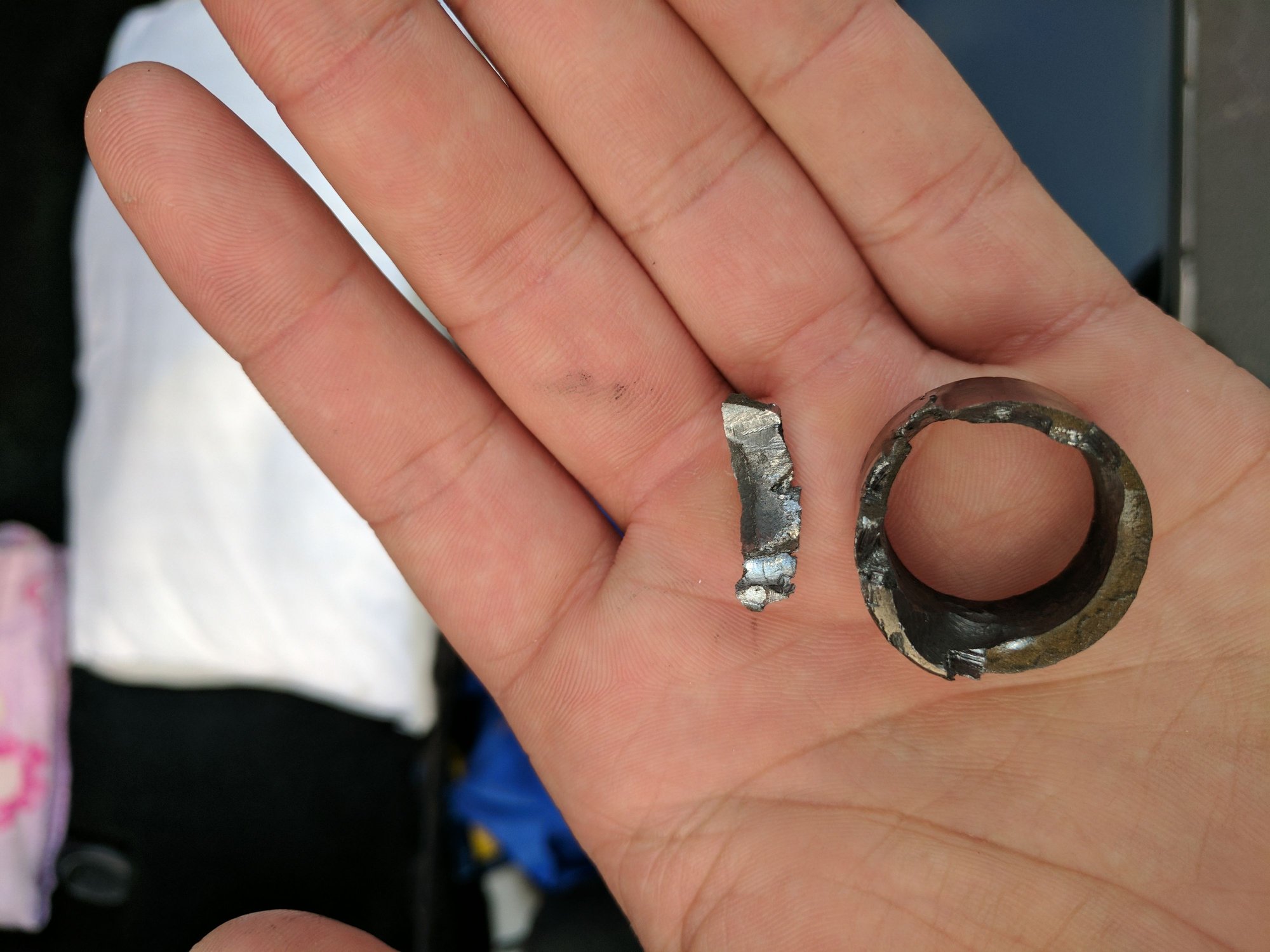

Where'd all the rollers go?
Old Jun 29, 2017 | 07:02 PM
sam-garcia's Avatar
sam-garcia
Joined: Jun 2013
Posts: 217
Likes: 7
From: Hampton, GA
Pic the mechanics took at the shop.
​​​​​​ Exactly what I was wondering
