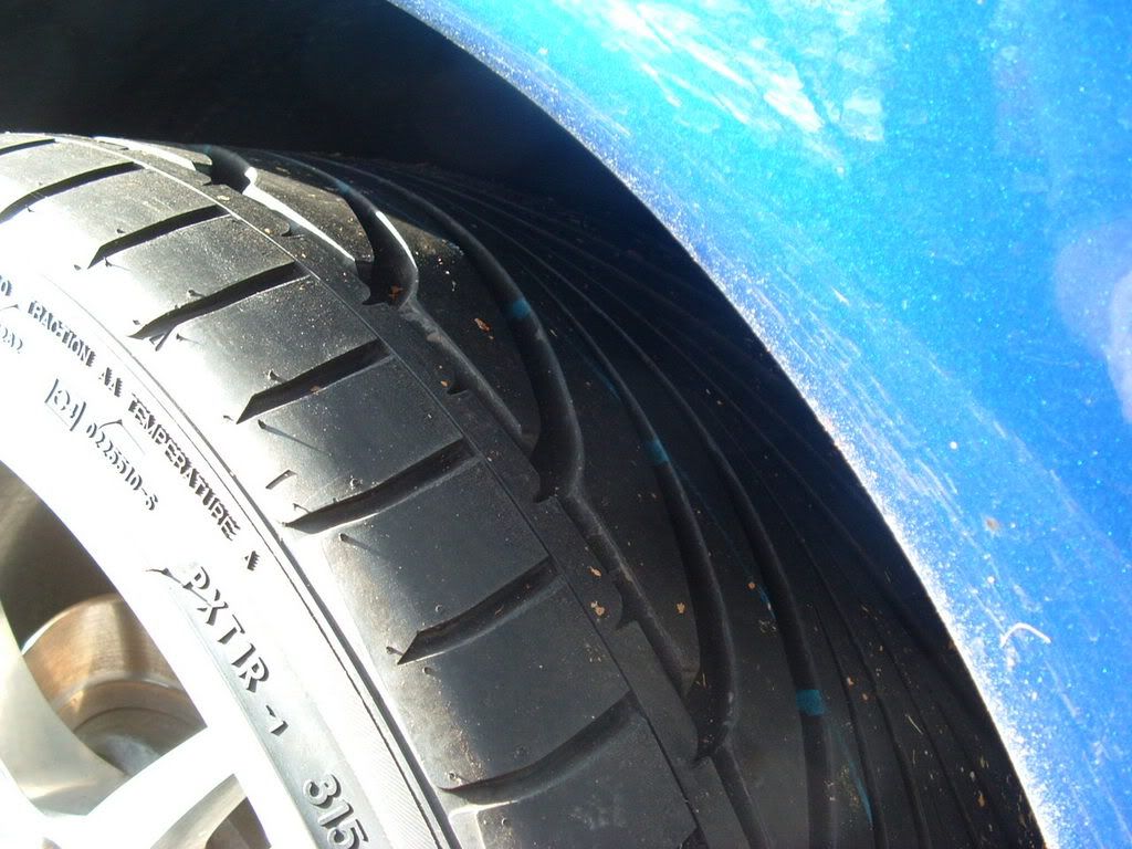

I have TOYO Proxies 315 20 19s on CCW 505As 11.5 wide on the rear of my ZO6. They fit FLAWLESSLY!
The tires DO NOT rub! There excellent!
