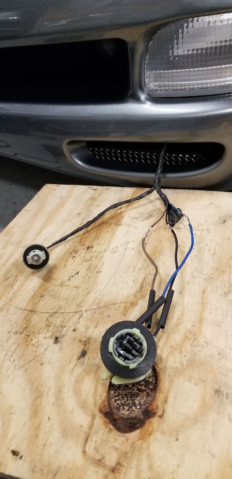

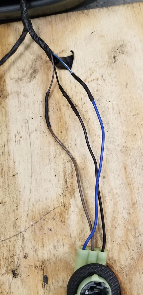

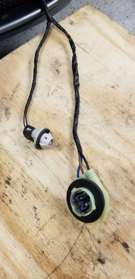

If you go in through the brake duct hole in the bumper, you will be able to pull the harness out far enough to work on it easily.
BTW, I had previously replaced the housing to make sure it was water tight. The problem returned after a while. When I decided to replace the old socket and got it into view, I could see that the inside looked kinda toasted.
