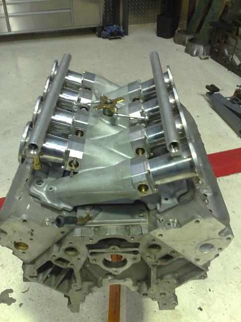

Look at this manifold:
http://forum.efilive.com/attachment....4&d=1213240341
http://forum.efilive.com/attachment....5&d=1213240612

each runner have a TB? who makes that? and is it under 10 billion dollars?
Old Jun 16, 2008 | 02:23 PM
dmiz0420's Avatar
dmiz0420
Joined: Dec 2005
Posts: 426
From: Northern Virginia
each runner has a tb, but it's all sychronized by a rod down either side which is controlled by that middle cross which is in turn controlled by a servo or wire from the back of the manifold.
I think it may be out in Australia. Usually these things aren't too expensive till they get here and see what a rediculous amount people are willing to pay for a plastic piece of FAST, then it becomes 10 billion.
I recently saw Rides where they were building a propane powered lsx block nova that had a very similar intake manifold where each "horn" of the intake had a seperate filter. They kept saying "this is the first car like this in the US", but all the tech came from Australia.
A while back I got a tip that there were going to be a host of new intake manifolds released this year for the ls series engines. I'm sure that's one of the reasons we've seen the price come down a little on some of the existing units out there.
The cool thing about the propane injection, they switched to liquid propane injection (even newer tech), and just the coeff of expansion of the liquid to gas once injected in the cylinder gave the engine the equiv off 3.5lbd of boost!
Now that's taking advantage of physics.
Here is the thread on efi live, the guy that has it is the poster, topfuelman. I'm sure he can give you more detail.http://forum.efilive.com/showthread.php?t=8261&page=2
