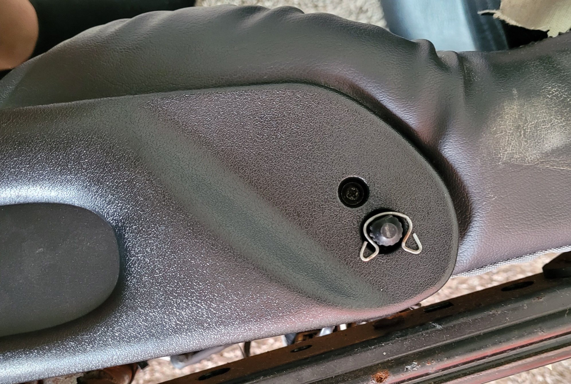

Old Sep 3, 2025 | 02:37 PM
rufeo690's Avatar
rufeo690
2nd Gear
Joined: Oct 2024
Posts: 2
Default Photos to supplement
I just tackled this job and wanted to contribute. My bezel was trash, and my cushion as well, so it was easy to show how it comes apart.
2 Screws
1 Clip
1 Push-In Retainer
Old Sep 3, 2025 | 08:29 PM

Old Sep 3, 2025 | 08:45 PM
rufeo690's Avatar
rufeo690
2nd Gear
Joined: Oct 2024
Posts: 2
Originally Posted by Bill Curlee
Where did you get the replacement bezel? New or used?
Good job.
I got the switch and the bezel new from eBay, for a total of $50. Works and looks great so far!
