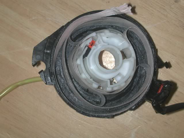

The problem is with the 'Clock Spring'. It is the connection from the steering column to the airbag. If the wheel is turned too far either way while disconnected from the rack the Clock spring will break.
The problem with the steering position sensor occurs if you don't get the steering wheel clocked properly to the rack when you reinstall the parts. Just make sure the wheels are straight and the steering wheel is straight and you should be alright on it.

thanks, the picture says it all. My steering wheel tends to center itself, so I'll just hook it up with the wheels centered up.
