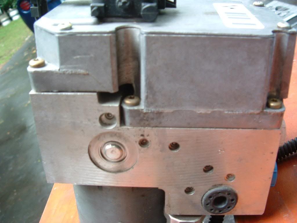

This id the entire EBTCM/BPMV unit:
This is the EBTCM part that you remove from the BPMV :
Relays located below the solenoid coils:

NOTE!!!!! There are SIX torx bit screws that secure the EBTCM to the BPMV and you disconect TWO connectors
EBTCM is SEALED to the BPMV with a black gasket and sealer so it will be tough to seperate. Make sure that you use sealer during the reinstall.
