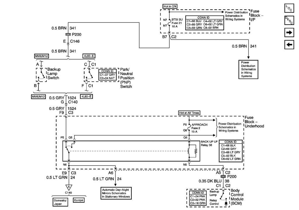

If you start troubleshooting, this might come on handy!

Pretty easy to dignose if it's the switch. Put the key in and turn to the on position and put car in reverse. Take a test light and see if you're getting power down to the end connector at tranny. If so, it's the switch.
To Reverse lights out
