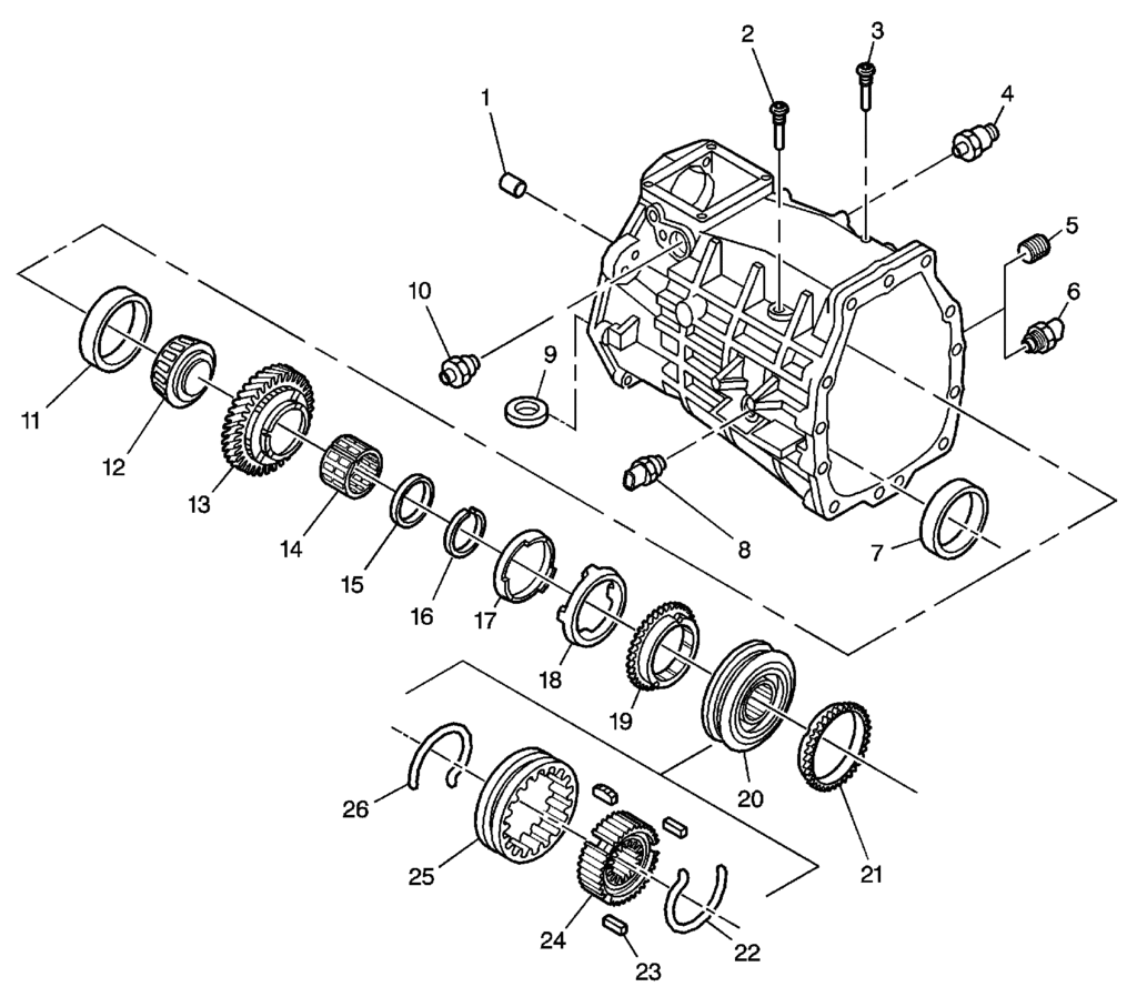

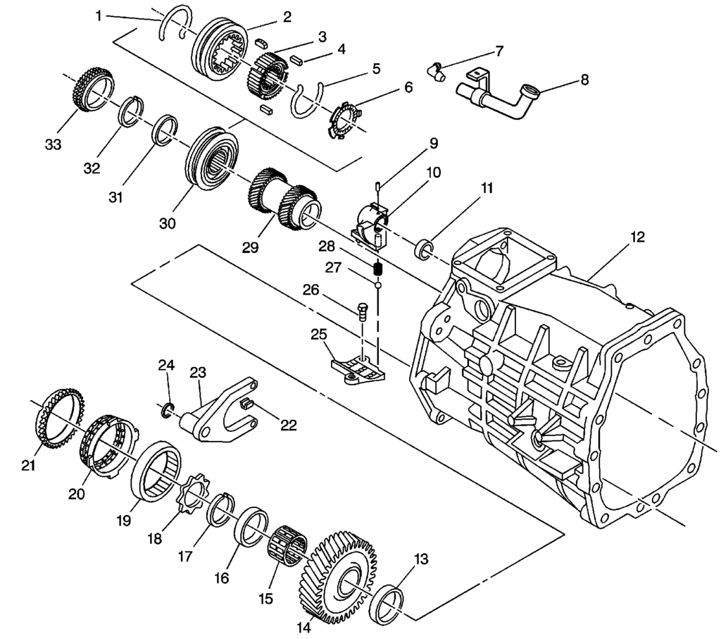

Where can you find a diagram, like the exploded view of an 02 tranny?

(1)Reverse Synchronizer Spring (2)Reverse Synchronizer Sleeve (3)Reverse Synchronizer Hub (4)Reverse Synchronizer Key (5)Reverse Synchronizer Spring (6)Reverse Synchronizer Key Retainer (7)Vent (8)Vent Pipe (9)Offset Lever Roll Pin (10)Offset Shift Lever (11)Top Shift Shaft Bushing (12)Transmission Case (13)6th Speed Drive Gear Bearing Spacer (14)6th Speed Drive Gear (15)6th Speed Drive Gear Needle Bearing (16)6th Speed Drive Gear Bearing Spacer (17)Synchronizer Retainer Ring (18)6th Speed Drive Gear Thrust Washer (19)6th Speed Drive Gear Inner Cone (20)6th Speed Drive Gear Friction Cone (21)6th Speed Drive Gear Synchronizer Blocking Ring (22)Reverse Shift Fork Pad (23)Reverse Shift Fork (24)Reverse Shift Fork Retainer Ring (25)Guide Plate (26)Guide Plate Bolt (27)Shift Detent Ball (28)Shift Detent Ball Spring (29)5th and 6th Speed Driven Gear (30)Reverse Synchronizer Hub and Sleeve (31)Reverse Gear Thrust Washer (32)Reverse Synchronizer Retainer Ring (33)Reverse Synchronizer Blocking Ring
(1)Case Rear Extension Pin (2)5th/6th Lever Guide Bolt (3)Interlock Guide Bolt (4)Computer Aided Gear Select Solenoid (5)Oil Fill Plug (MM6 Only) (6)Temperature Switch (M12 Only) (7)Countershaft Bearing Race (8)Backup Lamp Switch (9)Magnet (10)Shift Detent Assembly (11)Mainshaft Rear Bearing Race (12)Mainshaft Rear Bearing (13)1st Speed Drive Gear (14)1st Speed Drive Gear Needle Bearing (15)1st Speed Drive Gear Bearing Spacer (16)Synchronizer Retainer Ring (17)1st Speed Drive Gear Inner Cone (18)1st Speed Drive Gear Friction Cone (19)1st Gear Synchronizer Blocking Ring (20)1st/2nd Synchronizer Assembly (21)2nd Gear Synchronizer Blocking Ring (22)1st/2nd Synchronizer Spring (23)1st/2nd Synchronizer Key (24)1st/2nd Synchronizer Hub (25)1st/2nd Synchronizer Sleeve (26)1st/2nd Synchronizer Spring
Mark
BAM,,,,,,,,heres your schematic!
I have a PDF file of the entire rebuild procedure/ repair Manual. PM me your e-mail address and i will send it to you.
