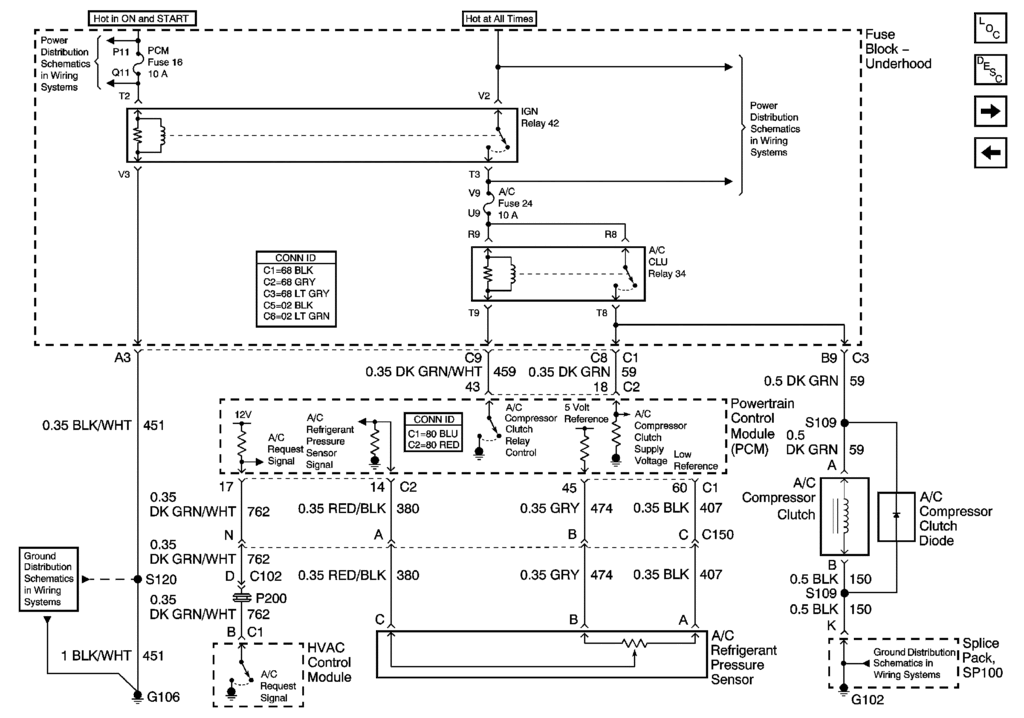

Ok, so I have a 2000 with the same clutch not engaging. Where is the clutch solenoid? I have power at the fuse #24. I need some help checking for power at the clutch. Is there a way to jump the clutch and force it on?

AC Compressor clutches don't fail often and the more usual causes are either too low or too high of refrigerant pressure. R134 systems are not like the old days of R12 where you could just add a can of refrigerant and be done for the day. R134 systems require a specific amount based upon system capacity AND ambient temperature. I would be looking at the two pressure switches first. Use an ohm meter on the compressor clutch leads to see if you have resistance. If you do, its probably good. If you don't, need a new one.
