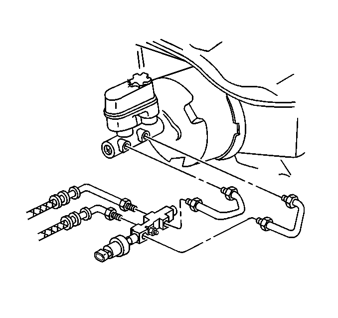

I've read every post I can find on this subject and, so far, no one has answered the following basic questions;
Where is the brake fluid pressure sensor/switch located (pictures)?
Can it be replaced, by it's self or, is it a part of a larger assembly?

I think it's part of the brake combination valve which is the gizmo located in the lower center of the drawing

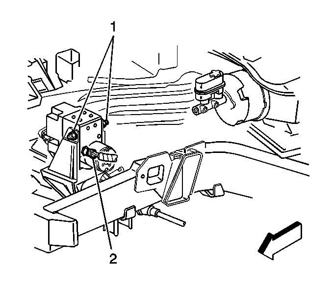

This is from '02 Service Manual, earlier models might be different!
Item #2

On my 01, instead of the distribution block shown in the drawing, there is a switch with a wire attached that is screwed in to the lower part of the plastic master cylinder reservoir - between the two lobes.
Thanks for your input.
Old Nov 23, 2009 | 10:16 PM
skylarkul's Avatar
skylarkul
Joined: Jun 2008
Posts: 319
Likes: 5
From: Justin Texas
This one looks like a pressure switch and is screwed in to the EBCM. It could be the one. It should give me enough information to ask the auto parts guys to look.
There were some changes between 00 and 01 but, 01 and 02 should be the same.
Thanks again.
Les
Item #2
Old Nov 24, 2009 | 10:17 AM
87SAM's Avatar
87SAM
Joined: Jan 2001
Posts: 4,386
Likes: 689
From: Boise ID
Yes the 01 manual shows it being #2 in byronhunter's drawing.
I don't think you would really have to drain the cooling fluid.
From the 01 manual:
Brake Fluid Pressure Sensor Replacement
Removal Procedure
Notice
To prevent equipment damage, never connect or disconnect the wiring harness connection from the EBCM with the ignition switch in the ON position.
Drain the cooling system. Refer to Draining and Filling Cooling System in Engine Cooling.
Disconnect and remove the radiator inlet hose. Refer to Radiator Hose Replacement - Inlet in Engine Cooling.
Loosen the two retaining nuts (1) and carefully reposition the EBCM to access the brake pressure sensor (2).
Disconnect the brake pressure sensor electrical connector.
Remove the brake pressure sensor from the vehicle.
Installation Procedure
Notice
Install the brake pressure sensor to the EBCM in the vehicle. Tighten
Tighten the pressure switch to 22 N·m (16 lb ft).
Connect the brake pressure sensor electrical connector.
Position the EBCM back into the support bracket and tighten the retaining nuts (1). Tighten
Tighten the retaining nuts to 10 N·m (10 lb ft).
Install and connect the radiator inlet hose. Refer to Radiator Hose Replacement - Inlet in Engine Cooling.
Fill the cooling system. Refer to Draining and Filling Cooling System in Engine Cooling.
Perform the Diagnostic System Check - ABS to verify the repair.
