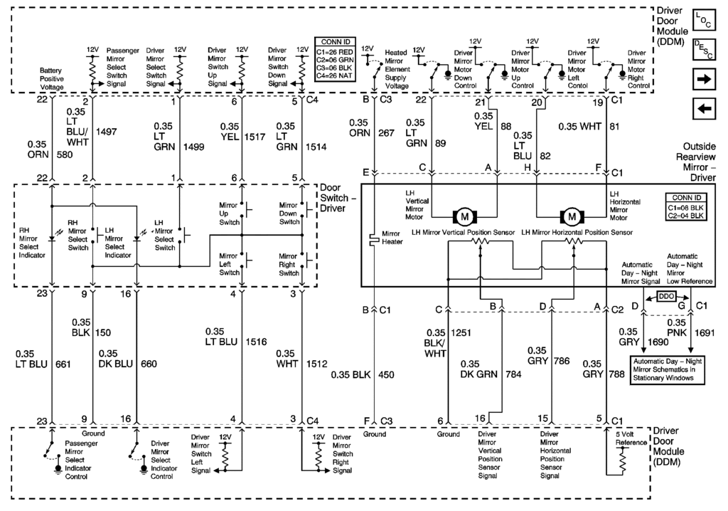

The driver's side mirror on my 2004 stopped working. Any suggestions on what the problem could be would be appreciated?

You need to give a better explaination! Wont go up? Won't go down? Won't go left or right. Anything else that don't work?

It wont move in any direction.

OK, here is the schemattic you need.
