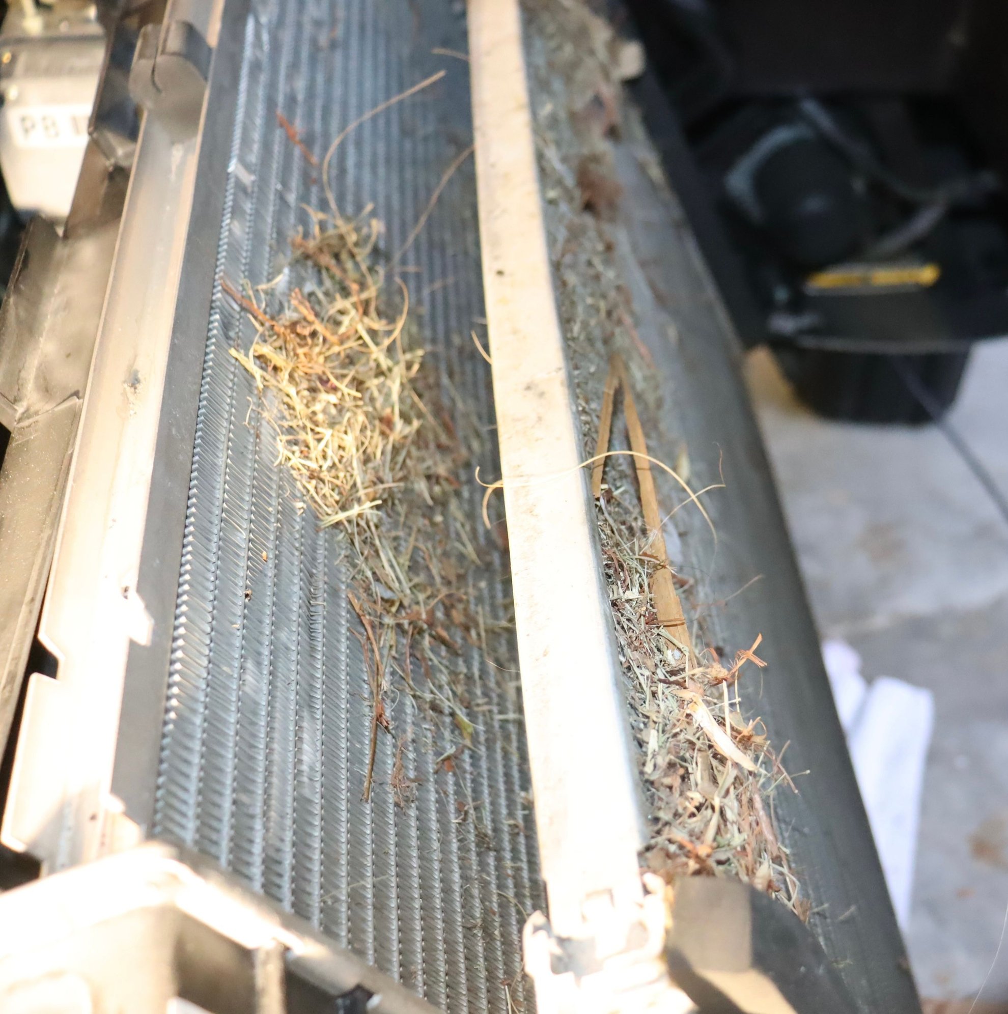

I had the same problem about a month ago and when changing the oil at home with ramps I noticded a piece of a plastic bag up in the radiator area. It was not visble unless you are on your back and looking directly up in that area. When I pulled bag ,out came some straw, grass, leaves, cigarette butts, so I went and got small tip air nozzel and blew up in there and still more debris, dirt, dust, came out. I was amazed. I made an extension for the air hose with a small long rubber hose added to the tip of the air nozzel so I could blow further up in the area and still more trash etc came out. By the way if you do this make sure you have on eye protection such as safety glasses and you will definitely need a shower afterwards. I plan on always checking this area of the radiator when changing the oil now and even if I dont see anything I am still going to blow that area out as a safe guard. By the way car is running 15 to 20 degrees cooler.

As Richard stated, the area between the radiator and condenser is small but for some reason is a serious vacuum and stuff some how gets in-between the two. It is not easy to clean them. Be very careful of the fins of the radiator and condenser when cleaning the area.

Yeah, it can get this bad and much worse!
You can remove the top radiator cover and look down but you won’t see as much compared to laying on the ground looking up.
A water/air wand kit off Amazon will do a nice job cleaning out the fins. Now you’ll need to get the car up about 10” to crawl under the front, but even just reaching up with your hand you’d be surprised how much junk you can wipe off.
