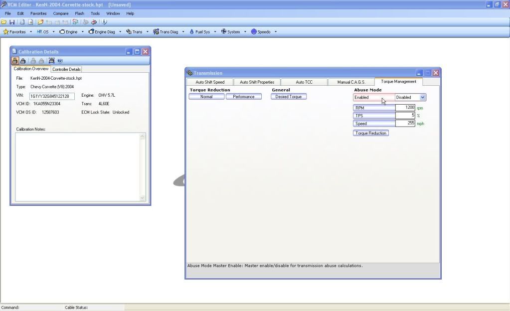

Disable the Abuse field in your tune as shown.

my tcs is disabled already does hat have anything to do with it, i dont have the tuning software...

Turning of the TCS with the stock abuse enabled will still cause the the spark timing to retard & cut out the injectors when brake torquing at 5% throttle angle & 1200 RPM.
Disabling the abuse field is the only way to correct your issue. I do this when tuning an A4 vehicle.
