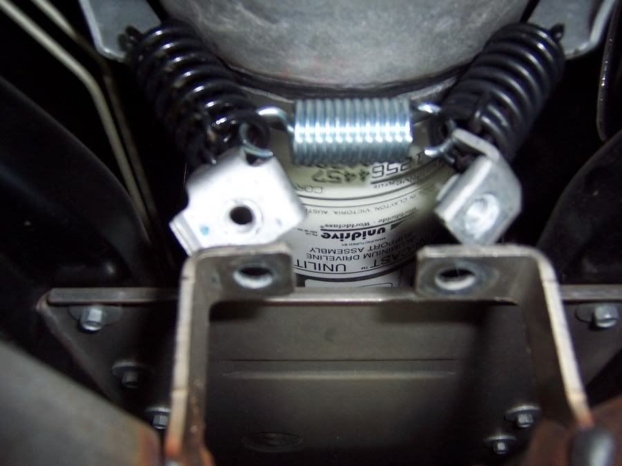

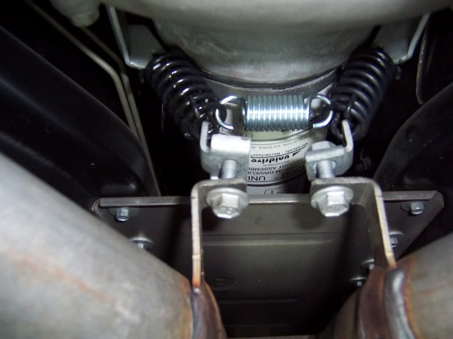

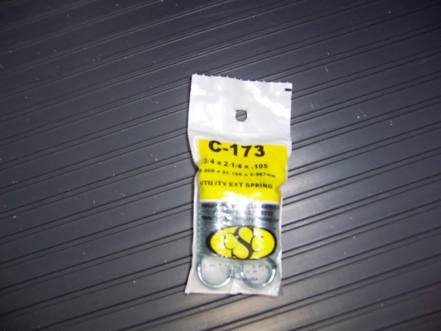

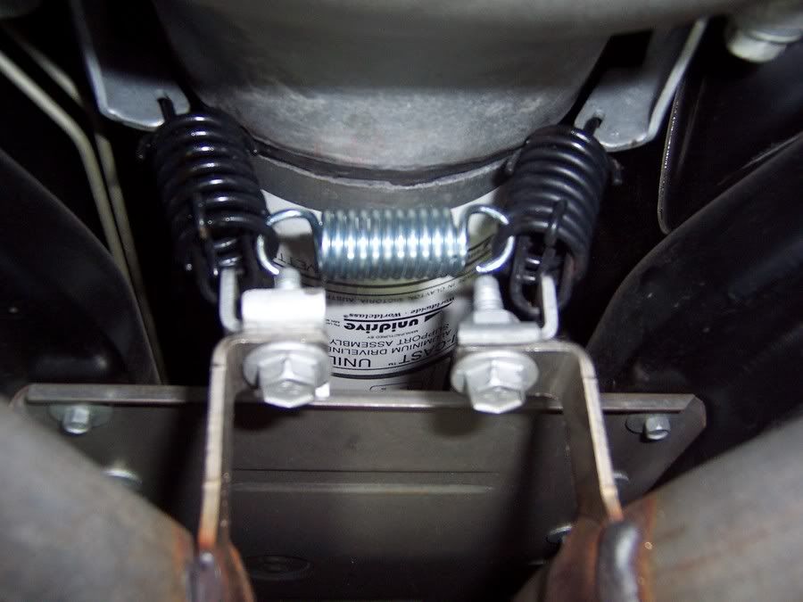

From what the OP stated, I believe it is when he is stopped. I have a similar sound/vibration also. Almost like the exhaust may be loose. I haven't had a chance to check it recently. I did read on here about some sort of spring near the exhaust that may be vibrating. I will have to search for the thread.
edit**found it
Originally Posted by devnull
Finally had a few minutes to look at what the heck was rattling under the car today. The rattle was the typical decelerating rattle coming from the exhaust. I put it up on the lift and put this fix in....
1) pic of the offending rattle. The springs here rattle against their hangers. You can tell just by shaking the exhaust here and it will sound like a storm door on farm house.
2) Got these springs at lowes for 2 bucks. They are very tight and will be used to hold the two H pipe springs together.
3) You have to unbolt the springs to put the holder spring on.
4) Put the sping on the lowest coil, and hand thread the bolts.
5) Tighten them down to 37lbs, and you will be rattle free.
I ran this car for a few miles and have noticed NONE of the rattles that were there before.
Hope that helps....
