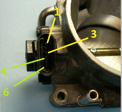

For informational purposes in case someone in the future has the same problem.. I can't believe there isn't an easily accessible writeup for this seemingly common problem. Save a lot of headache, and potentially money, and do the following:
1. Attain a digital multimeter
2. Aquire small/medium alligator clips
3. Go to your local auto parts store and buy a set of "safety torx" bits for $3
4. Don't fiddle with testing your TP sensor on the car, just take it off.
5. Attach negative alligator clip to the negative lead of your DMM, and the other end of the clip to the third (of 6) from the top prong inside the TPS
6. Attach the positive alligator clip to the positive lead of your DMM, and the other end to the first clip at the top (as was mounted on the car)
7. Set your DMM to Ohms
8. Ensure you have a starting number between 0-5, and very *VERY* slowly turn the center of the sensor as the TB would - watching that number on your DMM (do it a few times)
9. Reference my explanation below.
10. Now connect the negative clip to post 4, and the positive clip to post 6
11. Repeat steps 7-9.
Explanation:
The sensor is really two sensors, and in this case is represented by the top half of the posts and the bottom half. P1221 is generally caused when these two sensors disagree by a relatively small % for a VERY finite amount of time. If the sensor is working properly you should see the number on the DMM move up and down with full continuity, if the number displayed drops and comes back, even briefly, that is an indicator that there is a problem.
In my case both sensors hit an Open Loop right around 1.9-2.1. Granted this means they technically agreed but there needs to be continuity through the range. Also if I turned too fast (simulating a fast throttle response) it would often lose continuity and OLs would happen there too.
On a side note, the turning mechanism appears to have sediment of sime kind inside (feels sandy) and is likely just in need of a good cleaning.. I'll update with more when I perform sensor surgery.
[adding picture for clearer idea of pin layout if someone IS trying to do it on the car.]
