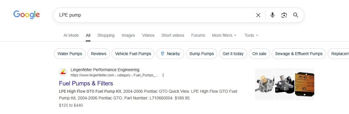

Pardon my ignorance but what is a LPE pump and how could that help with the fuel pump noise?
