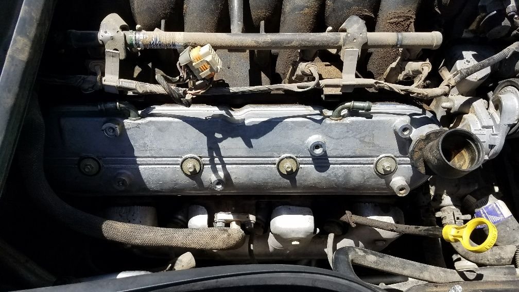

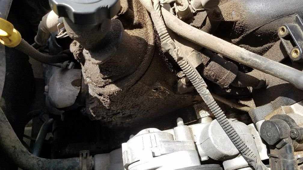

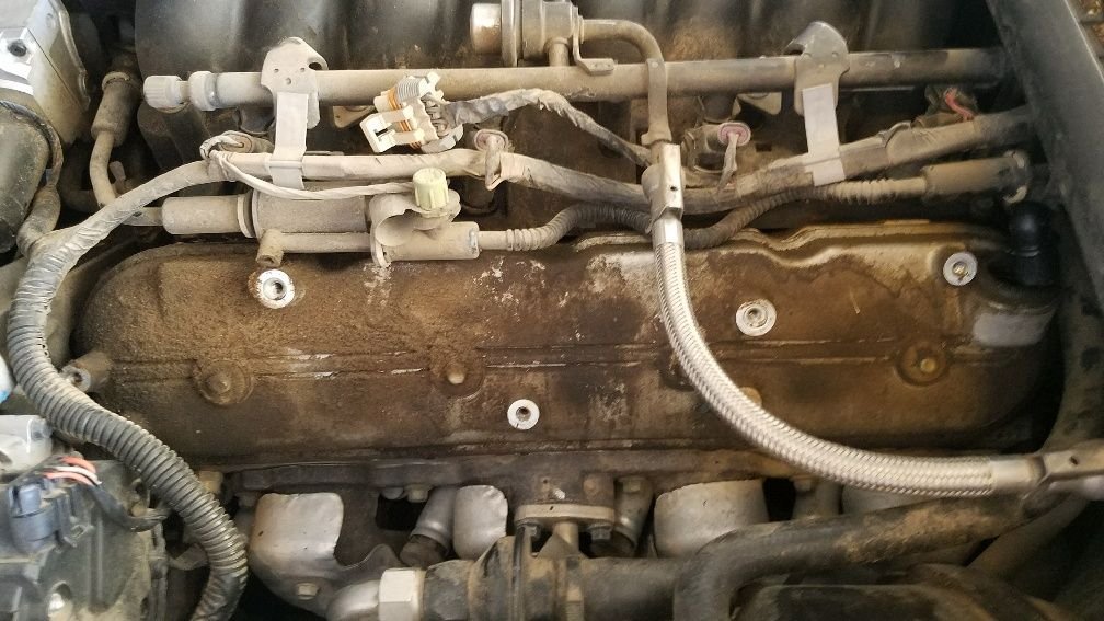

I finally completed my first repair attempt on my new 2000 Vette, replacing the valve cover gaskets, grommets, cleaning the grime off the engine, and tossed in a K&N air filter just for kicks. I was orginally planning to do the passenger side only, but saw that the driver's side was filthy also. Ironically, the leaks weren't from the gasket, they were from the grommets, but because of this the oil/dirt was confined to the top of the engine for the most part so the cleanup was a snap. And of course I made sure to take plenty of pics for my project album and to show off my newly sparkling clean engine:
The passenger side before starting.
The oil and grime had run down the front of the block too.
Driver's side didn't look as dirty, or so I thought....

I started it up and let it run for a while and didn't detect any leaks from the gaskets or the grommets. I also took it around the block and everything seems to be holding up great. I was a little worried about this repair, but now I feel great knowing that I'm finally back in a car that I can actually work on. I saved almost $500 by doing this myself.

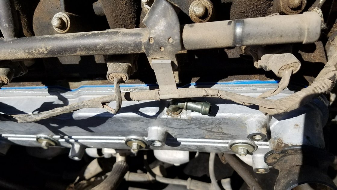

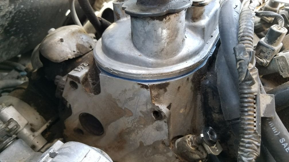

I bought my first Corvette 3 months ago... an '01 C5 base 6MT, 123k miles. I'm a Finance guy with very limited mechanical knowledge/experience, so I have a habit of turning 1-hour repairs into half-day jobs. Both valve covers were leaking on my C5, though, and the passenger side was obvious. With the help of this thread, I decided to tackle this job myself... and (I think) I'm glad I did.
Before-and-after, passenger side:
Before-and-after, driver side:
I also replaced the PCV tube assembly after re-installing the valve covers. As you can see from the first pic, there were oil leaks from the PCV valve and adjacent hose. That hose was very brittle and cracked/tore when I disconnected it from the intake.
My one concern about the valve cover gaskets is the gap I've got between the valve covers and the heads. It's about 1/8", and I was expecting them to be almost flush. I DID torque the bolts to spec (106 inch-lbs). On two of the "after" pics above, you can see the bright blue Felpro gasket. I wasn't expecting it to be so visible/obvious. Is this normal?
