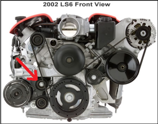

Can anyone tell me which ac pulley this is?
It is squeeking pretty bad but only when i'm giving it some gas or while driving. With the AC on or off it still squeeks

AC idler or tensioner?

Heres a better picture

That is the air conditioning idler pulley

A/C idler.

when I change that pulley, will I need to change the tensioner down there too?
and is it the same size as the main idler pulley?

While you're at it with the belt is off I would.

If it spins freely like a roller blade wheel...its bad...mine are off now.
Bitch to get at!
