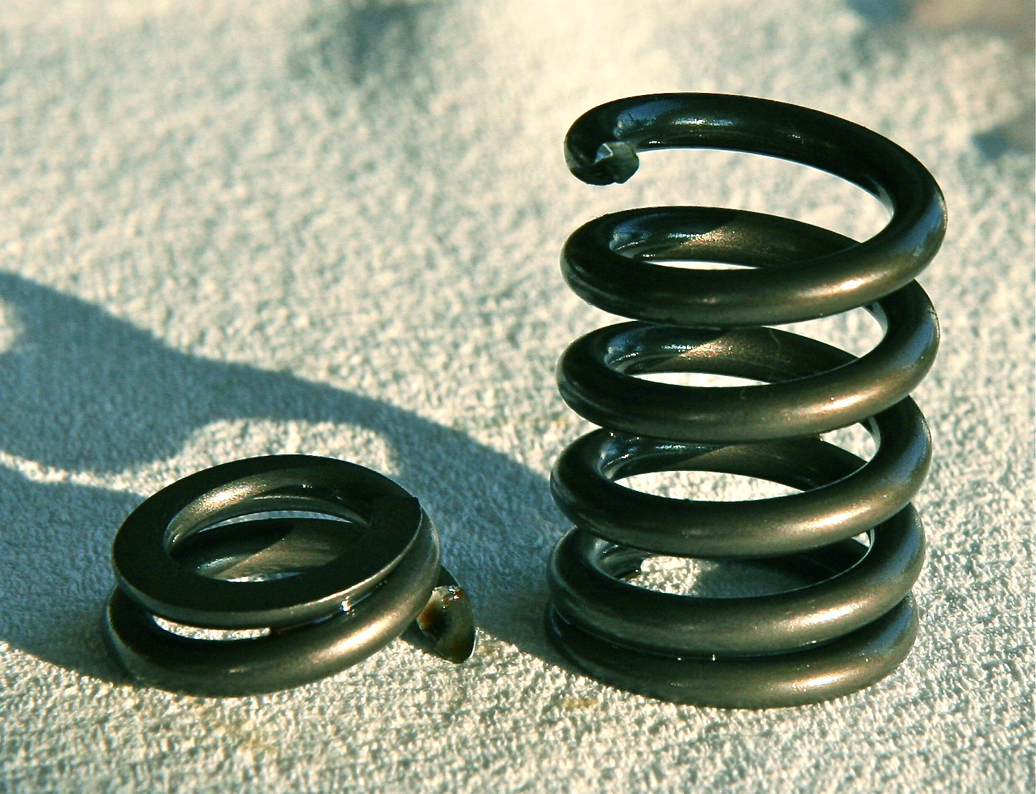

Wonder if you have a broken valve spring?

what is your indication that this may be the problem? I did compression test and all were 180's. would I have these symptoms if I have a broken spring but the valve did not drop? also would there only be a mis in one cyl ?
I had general misfiring with a P0300 code - I could not isolate it to one cylinder. I checked everything else - fuel pressure, manifold vacuum, MAF, replaced plugs and wires, reworked all the grounds, charged the battery.
Finally I took someones suggestion to pull the valve cover and look at the valve springs. That was the problem.
It might be your problem, but it is worth a look.

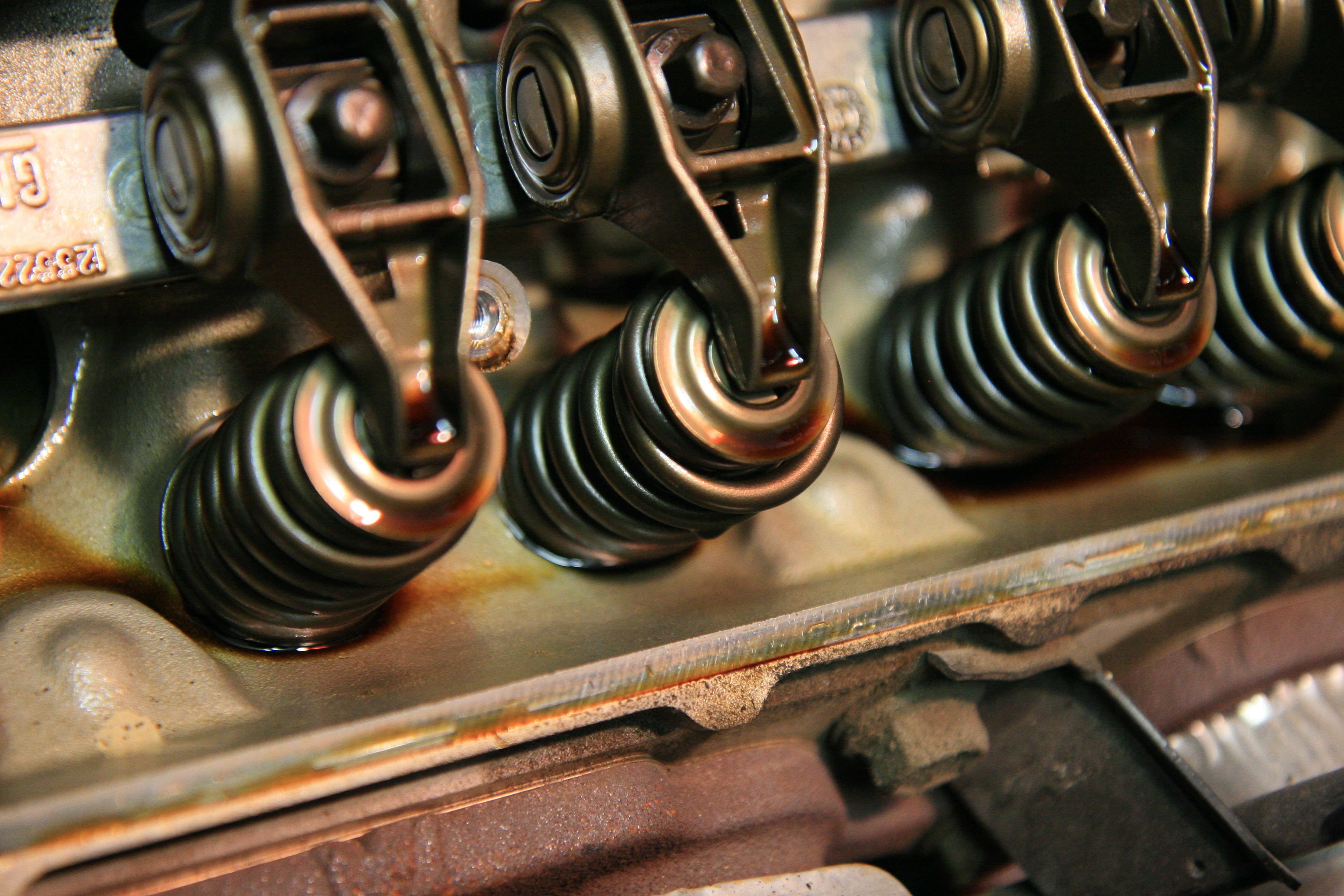

Last night I pulled my intake and valve covers.... Springs were beautiful, no cracks in the intake, I did have a pretty corroded knock sensor that I am replacing. Other than the KS I did not see anything out of the ordinary. I originally went in to check out the PCV system and was pretty anticlimactic. If anyone has a link on how the 04 PCV system works that would be helpful. I thought there would be a valve in there but its just a breather box... so I want to know if there is anything in this "PCV" system that can fail? In the mean time changing all the gaskets and cleaning things I found a small crack on the plastic under the o-ring on the fuel injector and wondering if this can cause a problem?

Don't think that crack would do much, how many are that way? I would suspect something in common with all the cylinders (wiring to the injectors, fuel pressure going low, etc).

That injector almost looks like it was molded that way. That is a sealing surface, but it's not _as_ important as the one at the top. If it were there, that could potentially leak fuel, and it would be at 60psi, so you'd know soon enough. If that is a crack and it wasn't molded that way, it does then indicate age, and it would be worth looking at all the others, especially the tops of them.

To spaz: there were two injectors that looked like this others were with out the "crack"
After everything was put together I went on a test run. Unfortunately I may have pinched a knock wire because I am getting p0332. So I am going to disassemble again. However the car is running smoother still a little hesitation. Wile I was at the auto parts store I thought I would replace my MAF again because I read you can have bad ones. It was under warrenty so why not. Now I am getting a p0101 first time this showed. However the misfire is not there on decel but still dying on me. So I'm going to fix the knock wire and look into the MAF code more.
