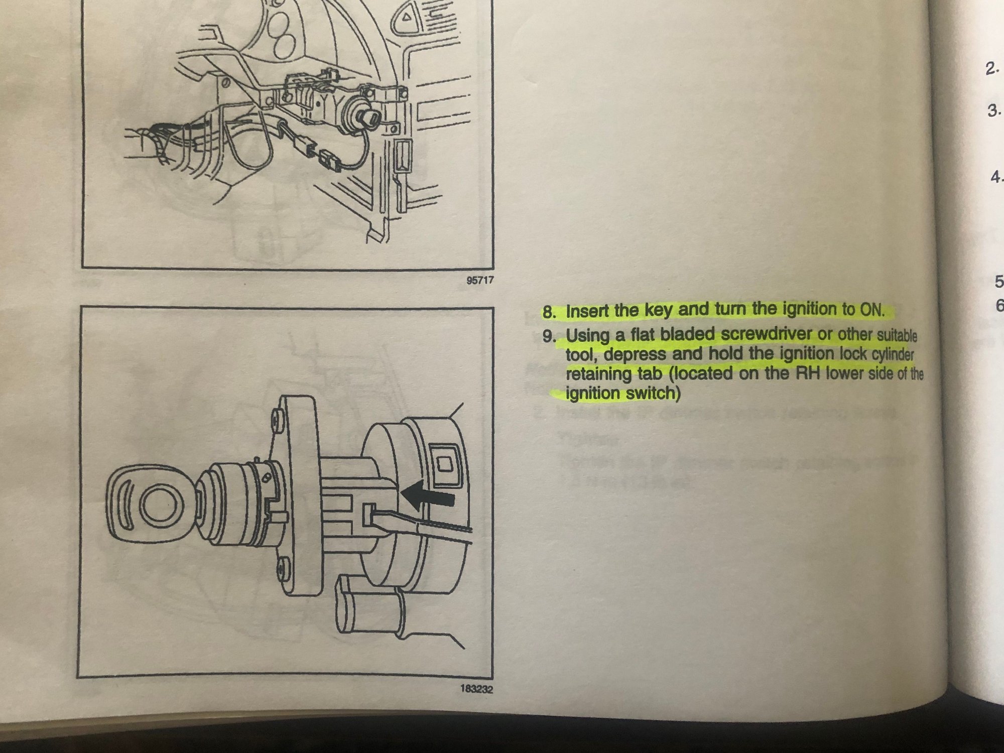

Thank you very much!! Heading to dealer now to pick up switch. I’ll let you know how it goes

Yes !!...stick with AC Delco !!...if you have never changed that switch before this is where everyone has trouble !!

Good the bad and the ugly!
replaced ignition switch with OEM and cleared all the codes. Started and HVAC all worked now and dash lights clear.
